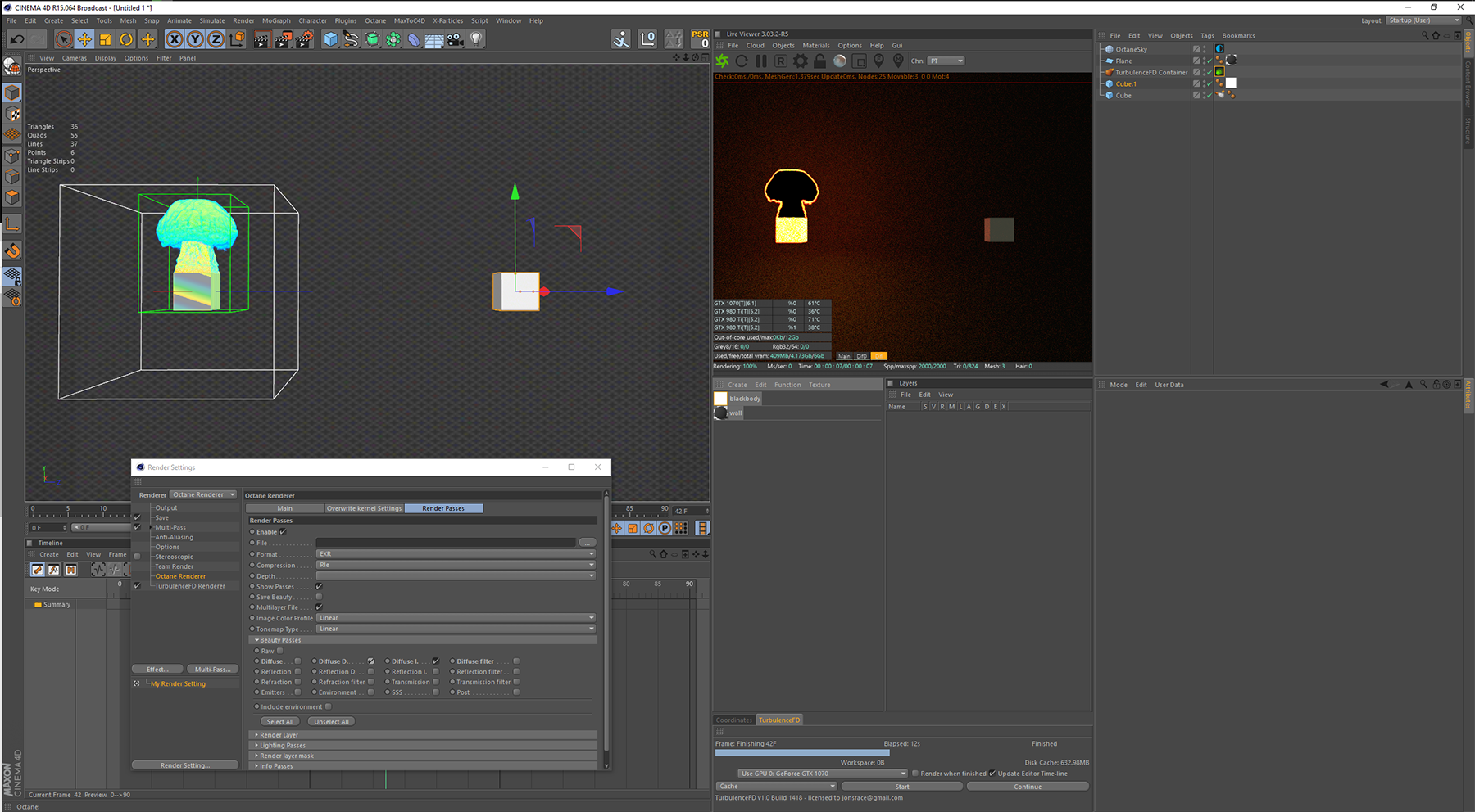

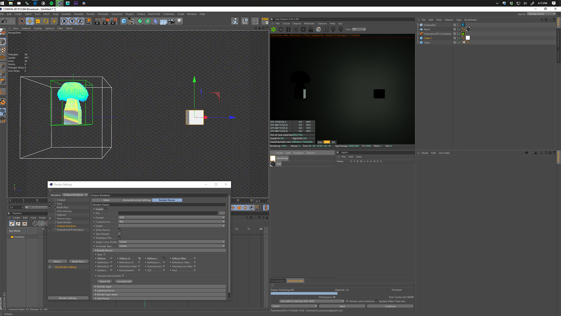

Sorry if I wasn't clear. Attached are 2 screenshots of a sample I made quickly.
I have a tubulencefd cube on the left and blackbody cube on the right, both are emitting light.
The Dif D. renders the blacklight's emission light and nothing else. The Dif I. renders the turbulencefd's emission plus the scene.
I want the light from the turbulencefd's emission to act like the blacklight emission in Dif D. Only the light emitted.
Is there a way to do this? Additionally, can you render an mask/alpha of the turbulencefd simulation while rendering the scene.
I'm really sorry if I'm not clear. I'm on an insane deadline and my brain is currently mush. Thanks

Posts: 10590
Hi JonRace,
unfortunately, volumes are not like standard objects and the interaction with render passes is limited, except for thr Render layers, you should be able to catch the alpha and other passes of the volume simulation with them :roll:
ciao beppe
