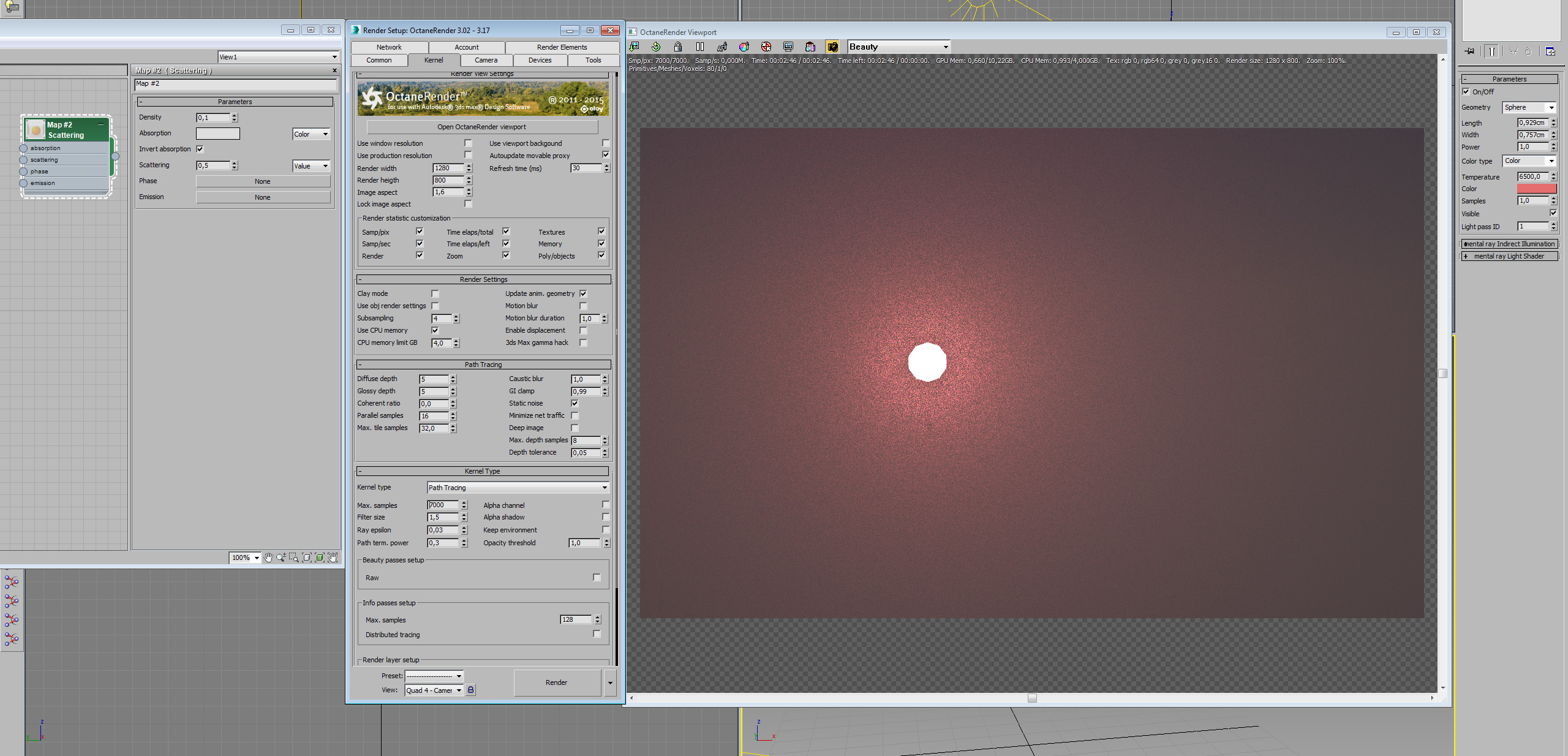

hello.
I have a problem with a noise.
7000 samples = noise.
16k samples = noise.
Always Noise!
Scene is very simple.
Sun with Fog + 1 light;
what is the problem?
DL - noise, PT - noise, PMC - noise, min\max GL - noise.
pls help. It plans to create a scene with fog and spotlights.
Noise Sun+Light

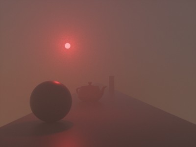

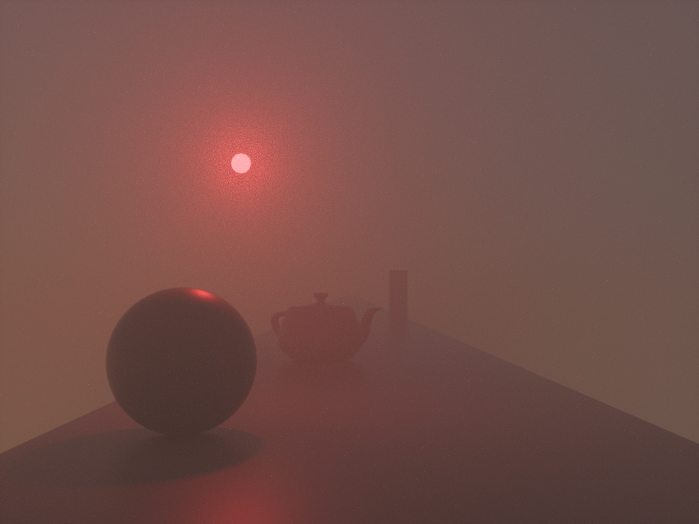

Hi LumaFX,
I am attaching a sample scene with fog.
I hope you can be useful.
I think you could play with Medium radius, sun power and scattering in the medium.
As in the file, to obtain a particular spotlight,
you could use two light sources: 1 to illuminate invisible 2 to obtain the desired visible spotlight effect.
Regards
Paride
Regards
Paride
