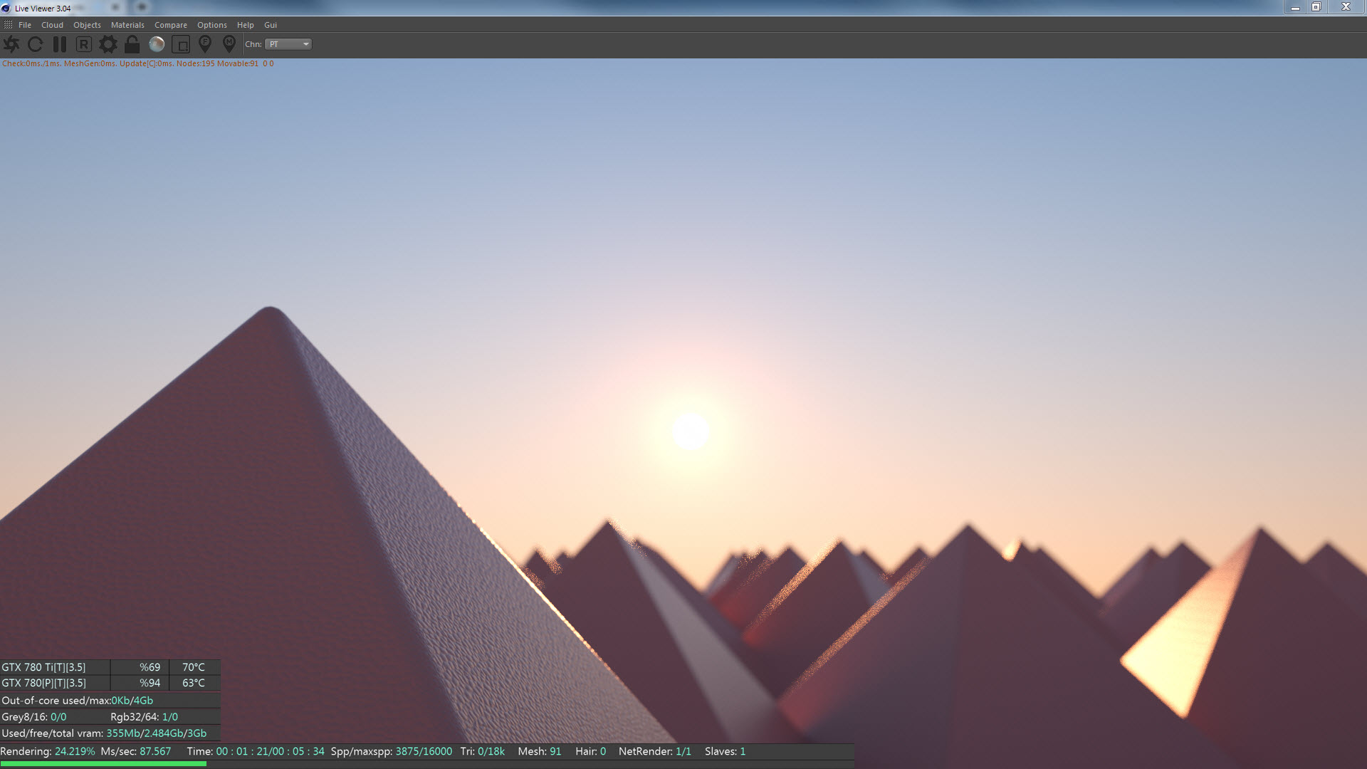

Hi everyone,
I'm sure it has been discussed many times since I already tried a few solutions from this forum but nothing works :
I have what could be a beautiful specular reflection on my scene, but it's very noisy and terrible when animated...
tried Hot Pixel removal, caustic blur parameter, increase roughness... None of this worked.
This only thing that would work is it just get rid of the specular. But I want it in my scene, that's part of what makes it beautiful.
Should I give up? :cry:

You need more maxsamples.

I tried. It doesn't change anything.

pyramid.zip
(84.09 KiB) Downloaded 187 times

Thanks for rebuilding the scene :))
1 - I can't afford this render time (and I have only one GPU so I guess it wouldn't be 5 minutes) because the shot will last something like 5 seconds.
2 - This will be animated with a camera, and I did the test : it flickers like hell when the camera moves. Your render would be fine for me if I was doing a print image, but I can see how it would react if animated and the problem would be the same especially with the far specular highlights. because they get calculated differently for each image, so it bounces a lot.
I feel stuck. It's for a client job and I bought octane especially. Little did I know that I could do a simple backlit sunset scene without having an issue with my speculars :cry:
Posts: 16068
Location: Türkiye
It's not bad at 4000 maxsamples after 1min. Try to a bit tweak with sundir/specular amounts. This is not a direct plugin issue but i'm trying to help anyway.
