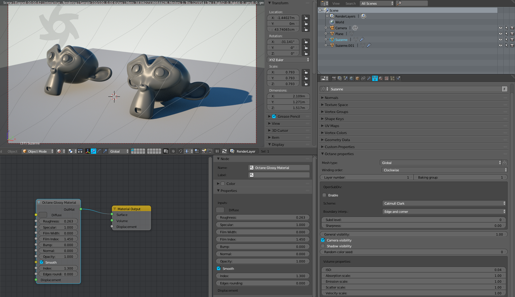

There is "Shadow Visibility" checkbox in Object Data tab but its not working in 2.25. In v3 it is working fine.
In standalone application it is working too using "Object layer map" node.
