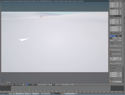

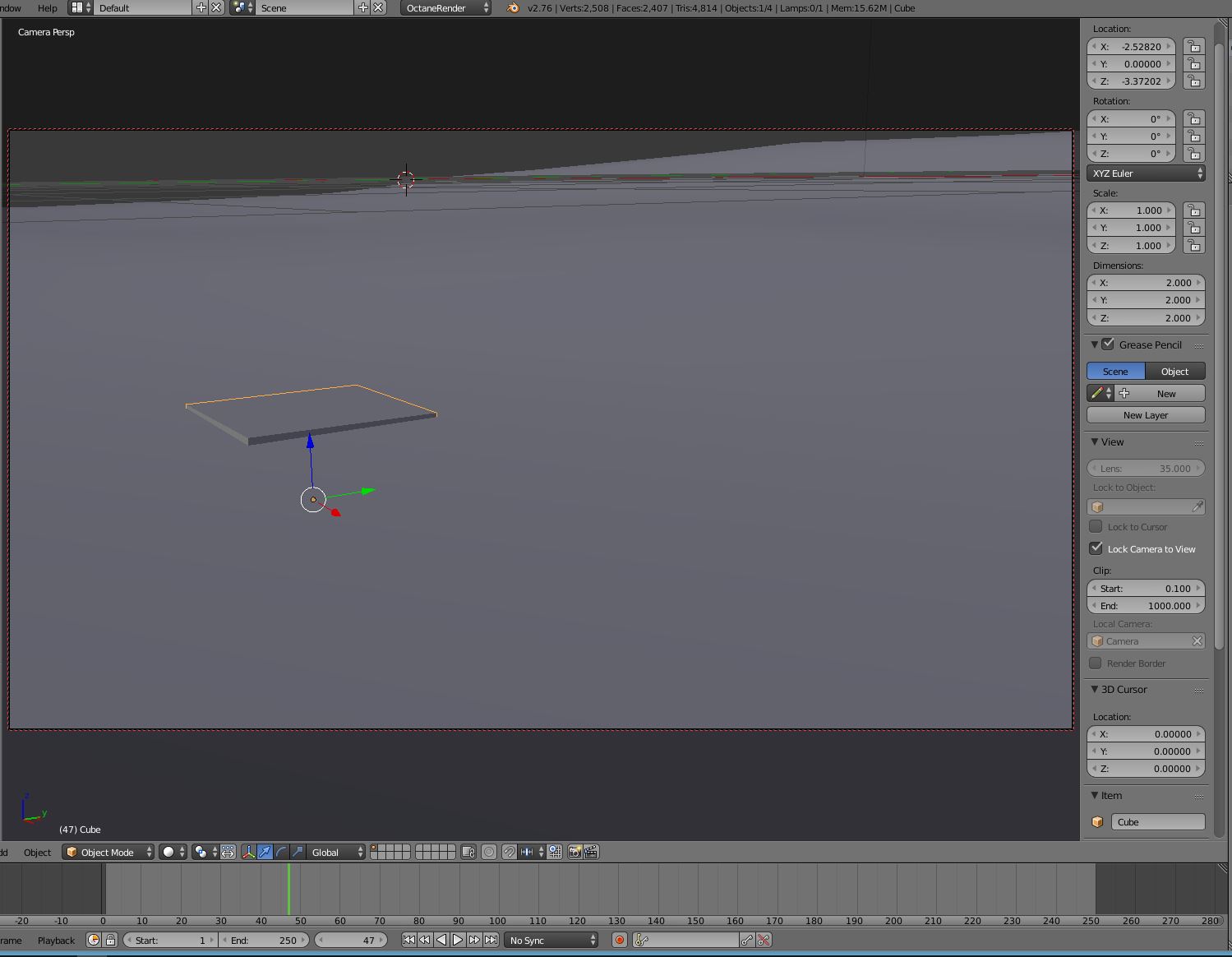

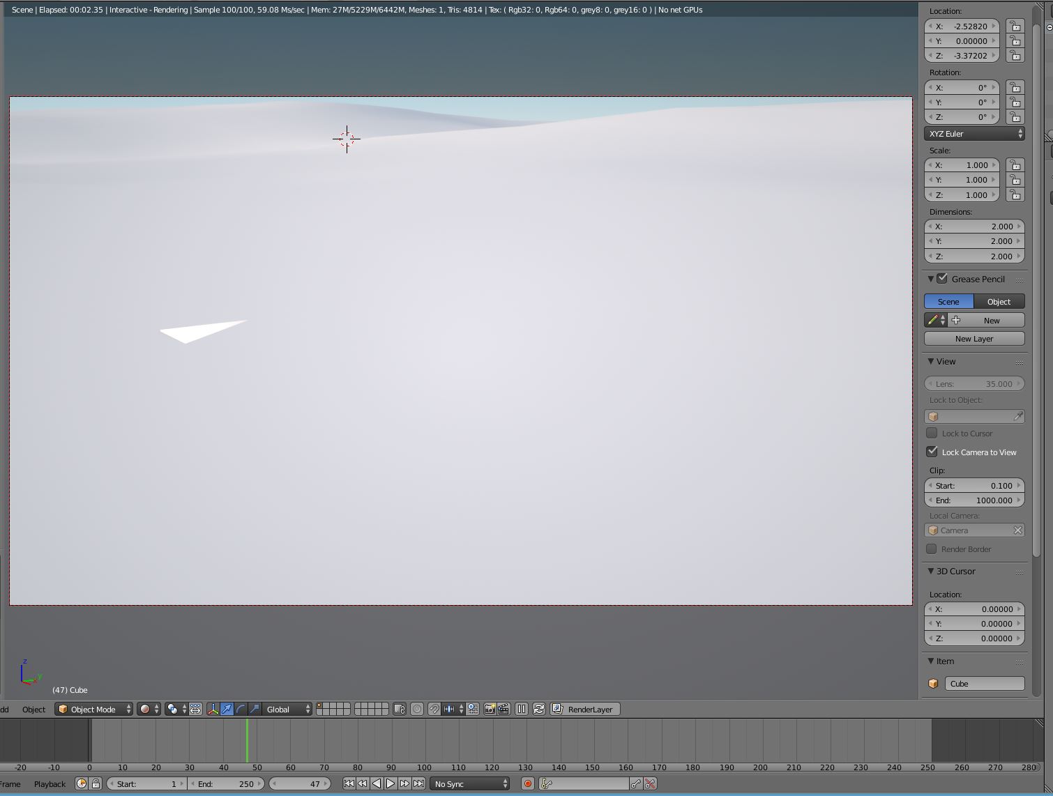

I just made a little ocean test here. Try it...
I'll attach Viewport and Render screenshots as well.
As you can see, there's an additional wave in the background of the render that isn't present in the Viewport, and the cube is almost covered in water in the render.
OceanExperiment.blend
(454.98 KiB) Downloaded 244 times

And, as you can see in the attached .blend, the water is higher around the cube in the midground as well.
Btw, judging by the attached .blend, the problem might seem minor (only one additional wave in the horizon and a few inches higher waters in general). But this test version is a very small ocean. I have much larger oceans in my real projects, and the entire horizons are several meter higher in the render than in the viewport.
So this is a serious issue, at least to me.
