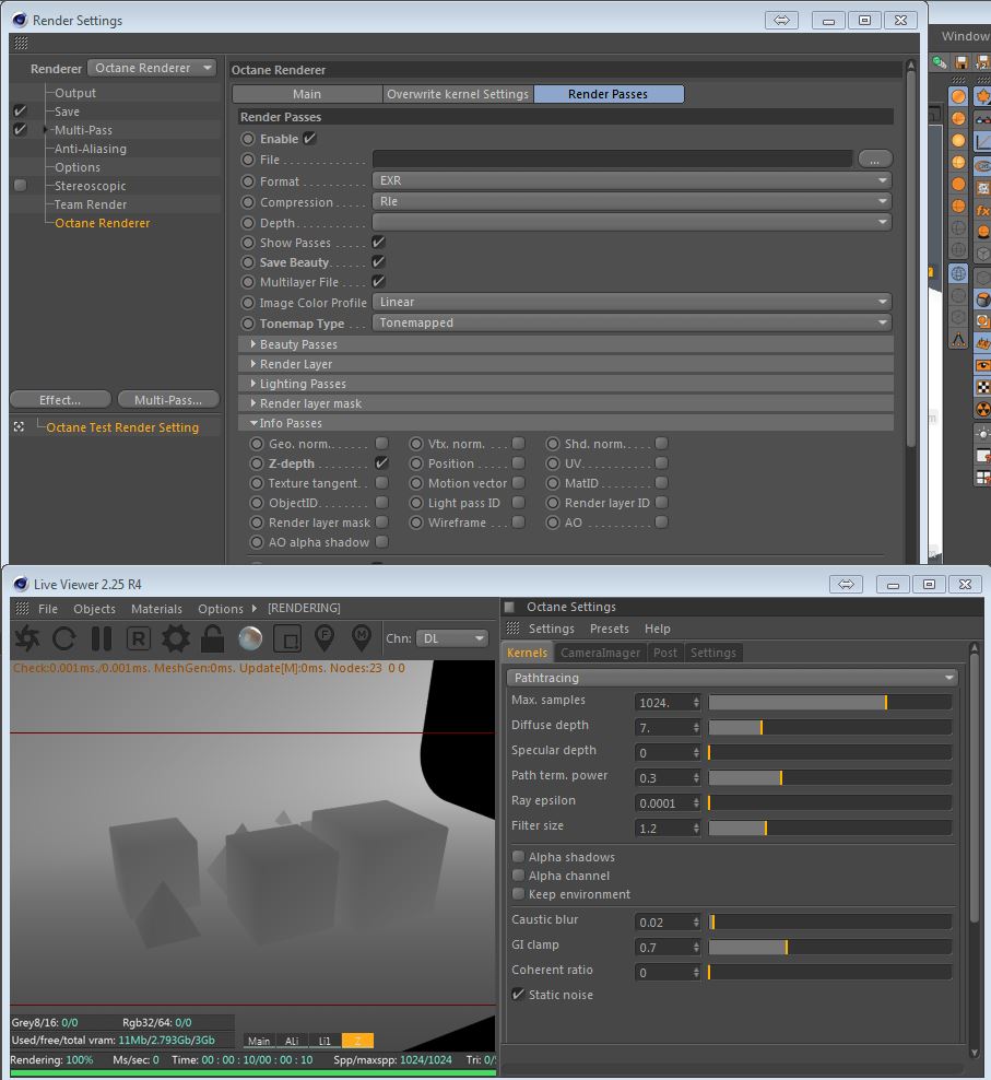

I'm trying to do multi-pass render. But my render passes is not there in my octane setting window - can't find render layer. I do have render passes in my general render settings. I'm using Cinema 4D R17 and Octane 2.25
Posts: 10619
Hi nanmunkh,
the Render Passes setting has been removed from the Octane settings, and now all the settings are done in the Render settings windows. THis works for both Live Viewer and Picture Virwer. Having the same settings in two different places was confusing.
