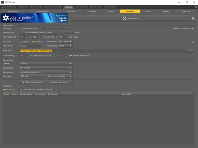

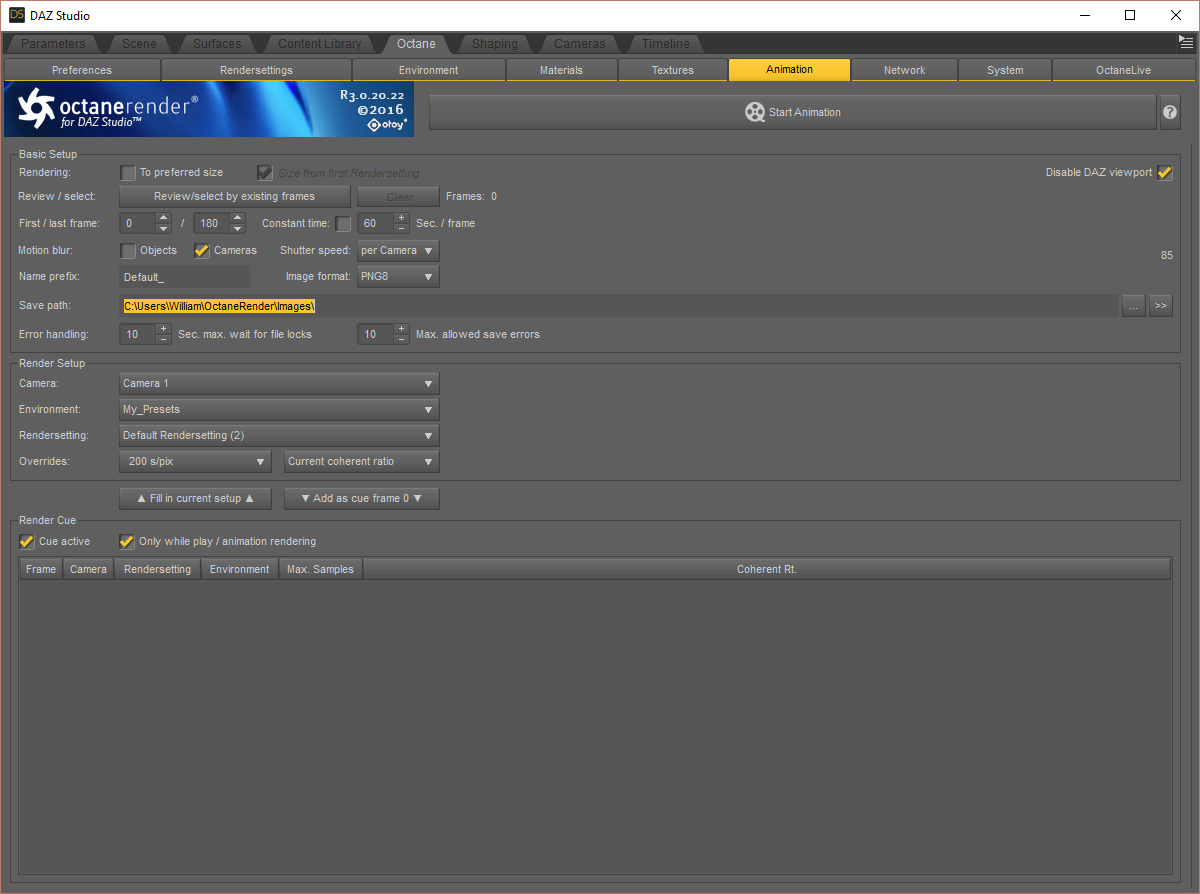

Help! I'm trying to do an animation in Octane 3 and all I get is a black screen for each frame. If I render a single frame, then it renders to the Octane Viewport fine. I haven't changed any camera settings, and this screenshot is of my animation settings. Is there somewhere I'm going wrong? I'm having a devil of a time trying to figure this out.
Here are my animation settings

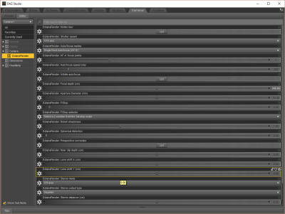

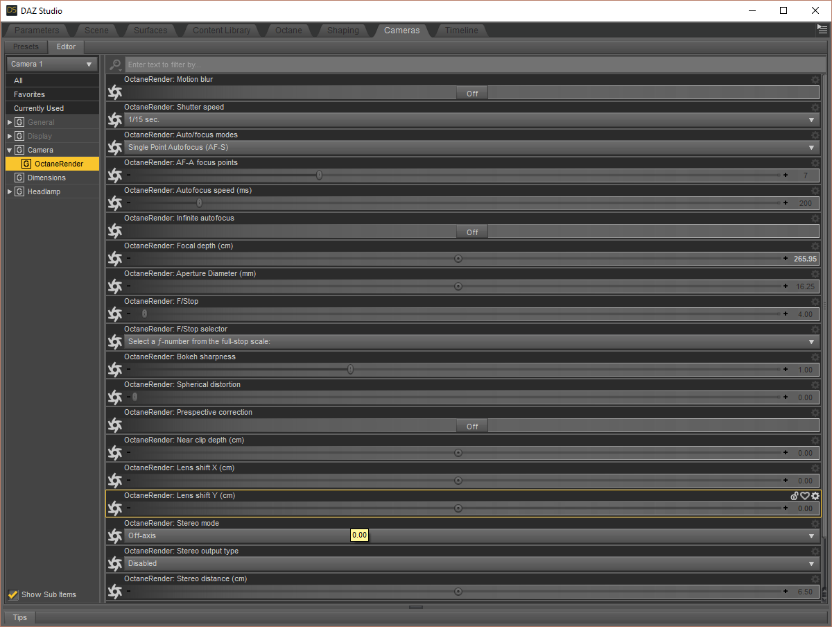

Here are my Camera Settings

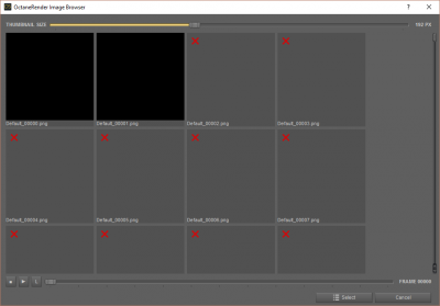

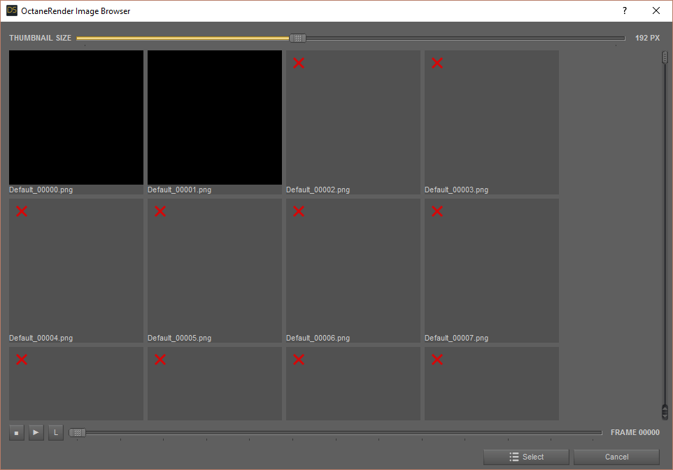

And here's what I get out

Also - try unticking Cue Active.
Paul

Try unticking "Disable DAZ viewport" I had some issues with this option.
