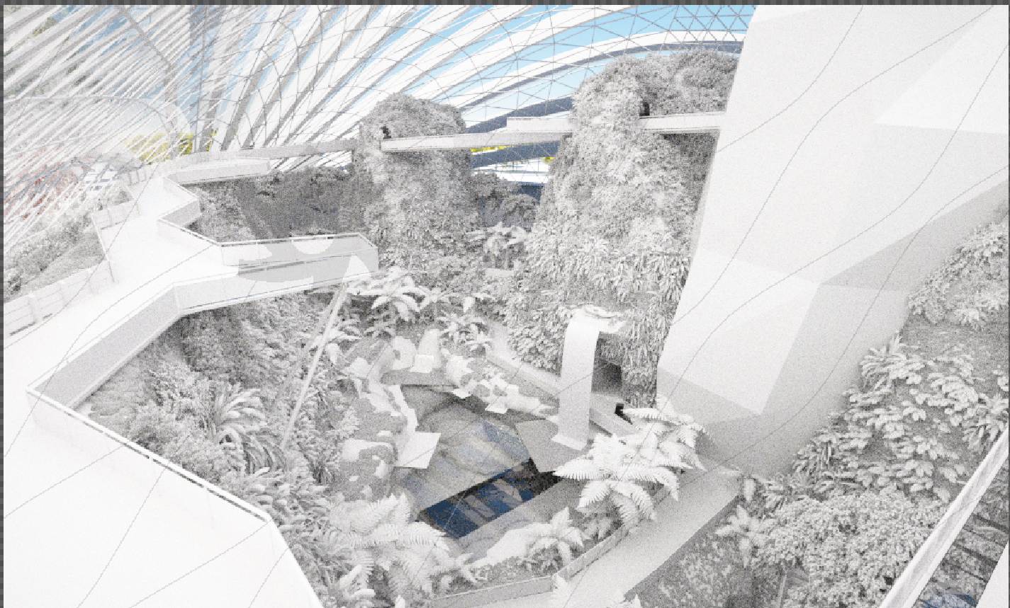

Now i tested on another scene in which i merged from xrefs scenes. It came through with almost all materials missing, maybe because i merged from Xref??
Image attached
Image attached
Should be because of the xrefs. it's problematic as far as I know.voltaire585 wrote:Thanks paride4331 it would be good to get the movable proxy thing fixed.
Image attached
Could you test this or similar scene with xrefs merged as objects to scene and renders fine on 1.9. and test the conversion again.
So far few tests I did..
and my scenes that are smaller scale (like single object and so on )got converted ok. didnt do a through test...
I wonder what you'll see with this scene conversion without the xrefs?
