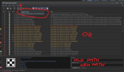

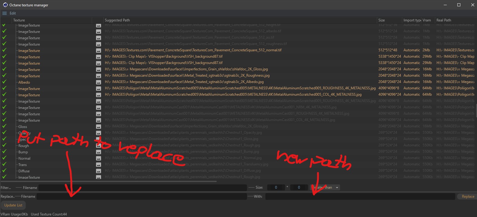

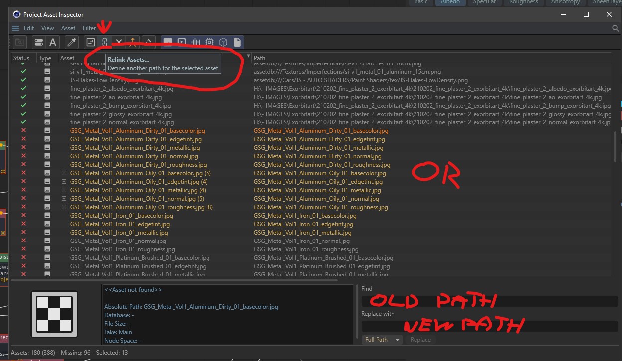

Octane Texture Manager :
Project Asset Inspector :
You do not have to select textures just put their old path ( without texture name ) and new path like :
old : H:\- IMAGES\Poliigon\Metal
new : D:\Textures\Metal
Architectural Visualizations http://www.archviz-4d.studio
