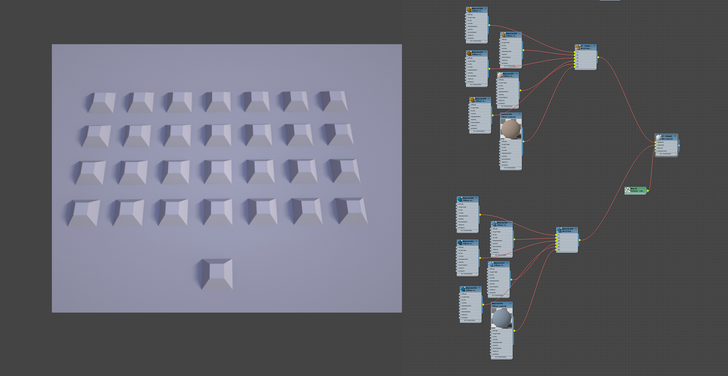

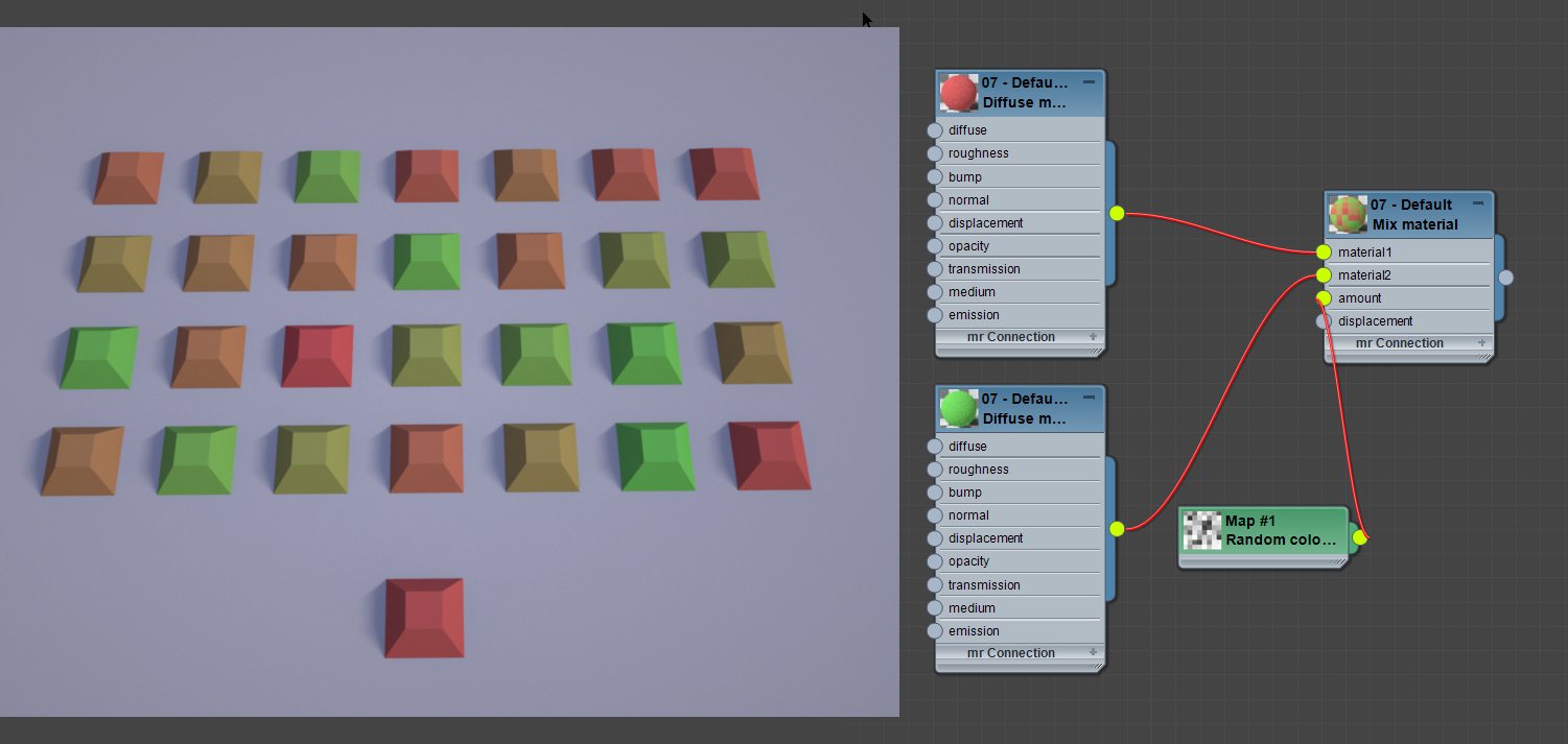

It works in simple material setup like this.

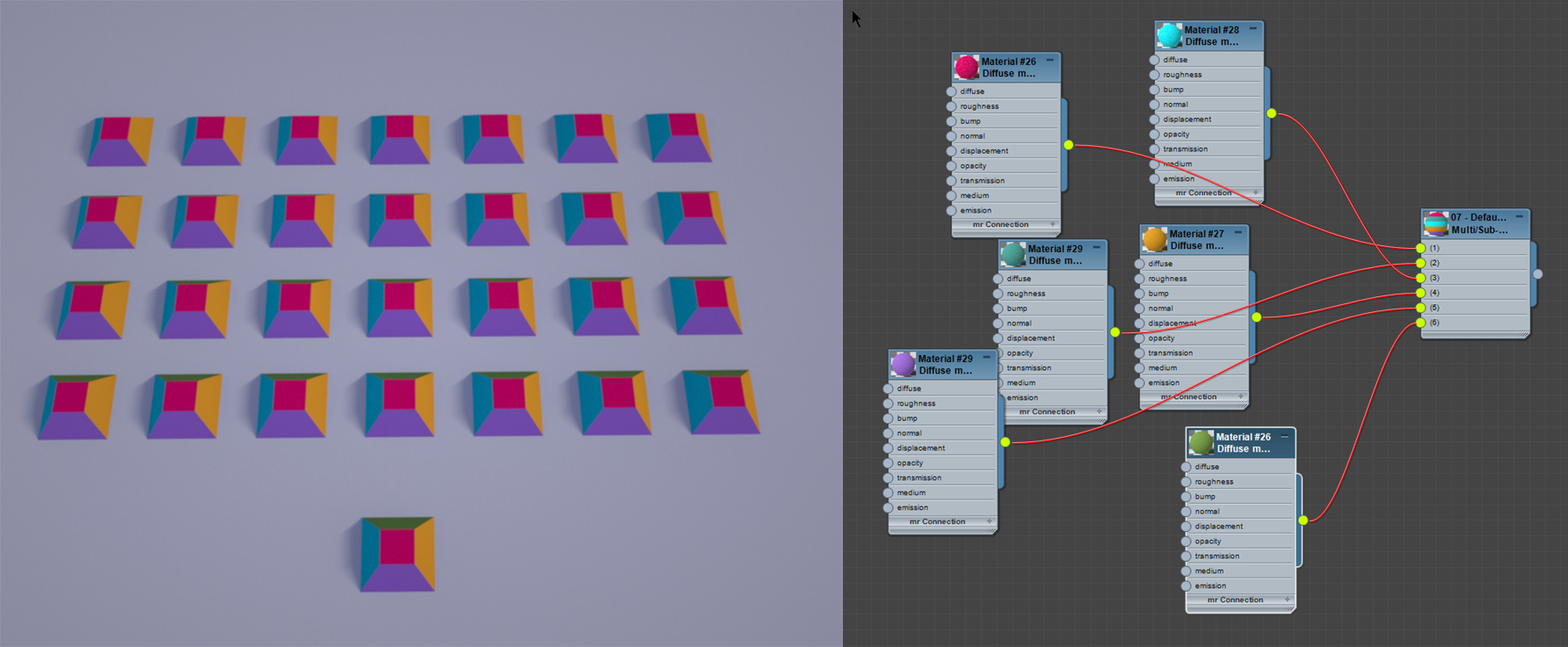

Below objects have different Material ID's on every polygon. Here I didn't use the Random Color Tex as mix Amount yet
Result is

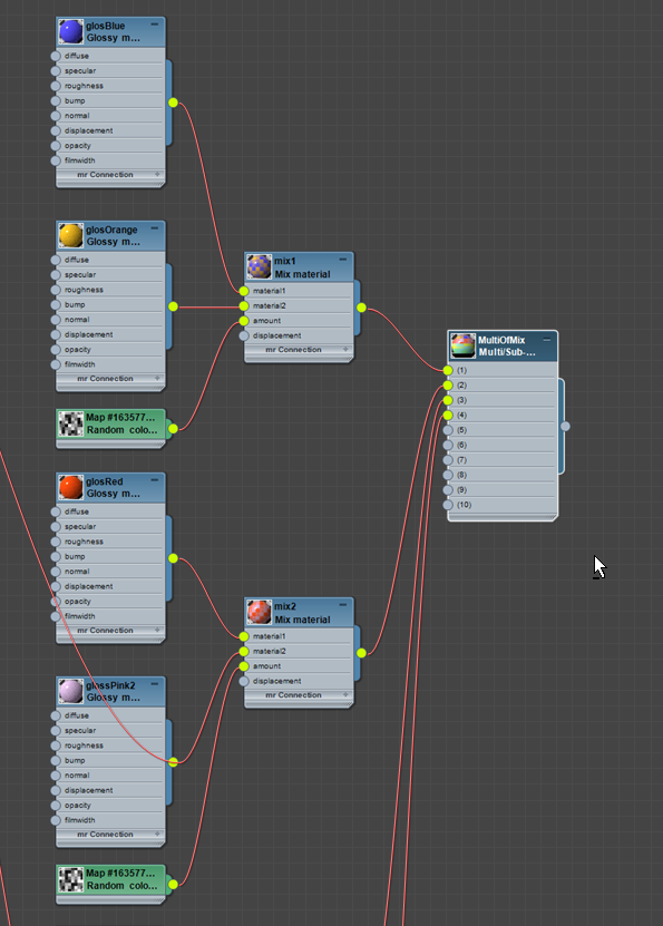

But when I want to make it more detail I want to randomize between two separate Material ID's.
Please let us know if you can fix this.

Hi Oguzbir,
Multi/Sub objects is a 3ds max feature.
The problem is when you want to use Multi/Sub objects with an octane node (material mix).
As you can see, Octane SA does not support the Multi/Sub objects, it simply assigns a different material to the object.
To get what you want, you should use multiple mix material with random color texture map
or a material with a color gradient map and a random color texture map in diffuse slot.
And do not forget to work with Random Seed parameter in random color texture map
I am attaching a sample file.
I hope you can solve your issue.
Regards
Paride
Regards
Paride

Hi Oguzbir,
As Paride suggested, a multi material using as many mix material as you have of material IDs will be a good work around.
Using multi material of 'mix' with copies of single materials, and a different seed for each IDs worked for me.. The use of 3dsmax multi material as input of octane nodes won't work indeed, and I'll try to implement an automatic replacement in the future..
Regards,
neonZorglub
Regards,
neonZorglub
