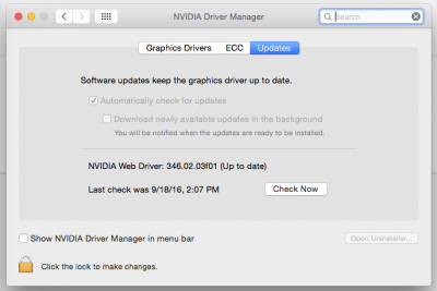

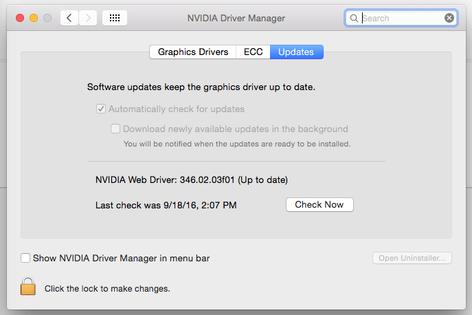

Screen Shot 2016-09-18 at 2.11.25 PM.png (24.2 KiB) Viewed 3641 times

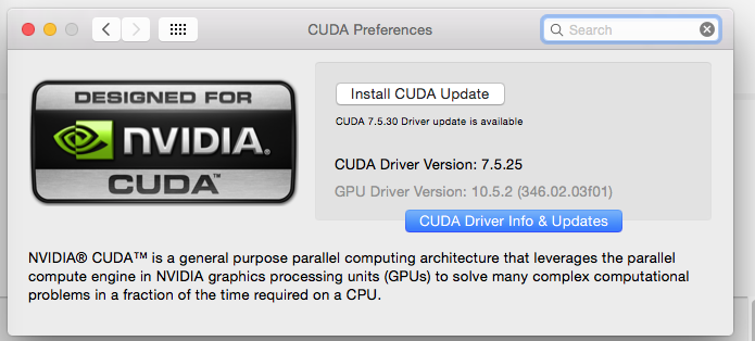

More info about my Cuda and Web Driver:

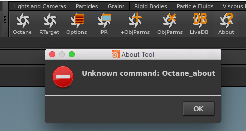

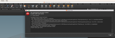

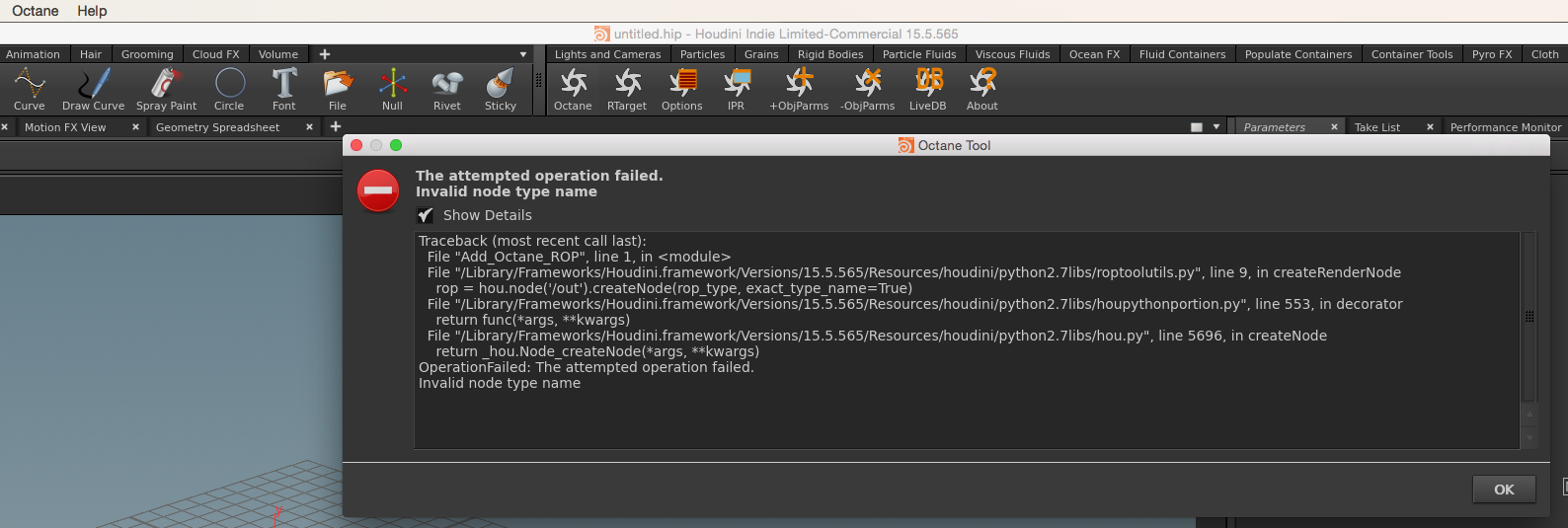

When I launch houdini I see the octane shelf and the top menus, however nothing will launch, and I get errors like these below:

Are you trying to install the demo version? The latest demo version available is the 3.00.20.0, so if you are installing the 3.03.3.0 version, you are working with a commercial build, not a demo build.
Anyway, even the commercial build without licenses should not have this kind of errors. These errors mean that the plugin folder can be found by Houdini (so the HOUDINI_PATH variable is right), but the plugin .dylib can't be loaded or it is not found.
If the Standalone or other plugin work fine in your system, the problem doesn't seem related to your GPU or CUDA installation. The problem can be your Houdini version ... You are trying to install the 15.5.523 plugin in Houdini 15.5.565. The plugin and Houdini version should match to avoid problems.
Anyway I'll release an updated demo build, with versions for the latest H15.5 production builds, for the next plugin release.
