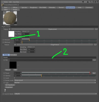

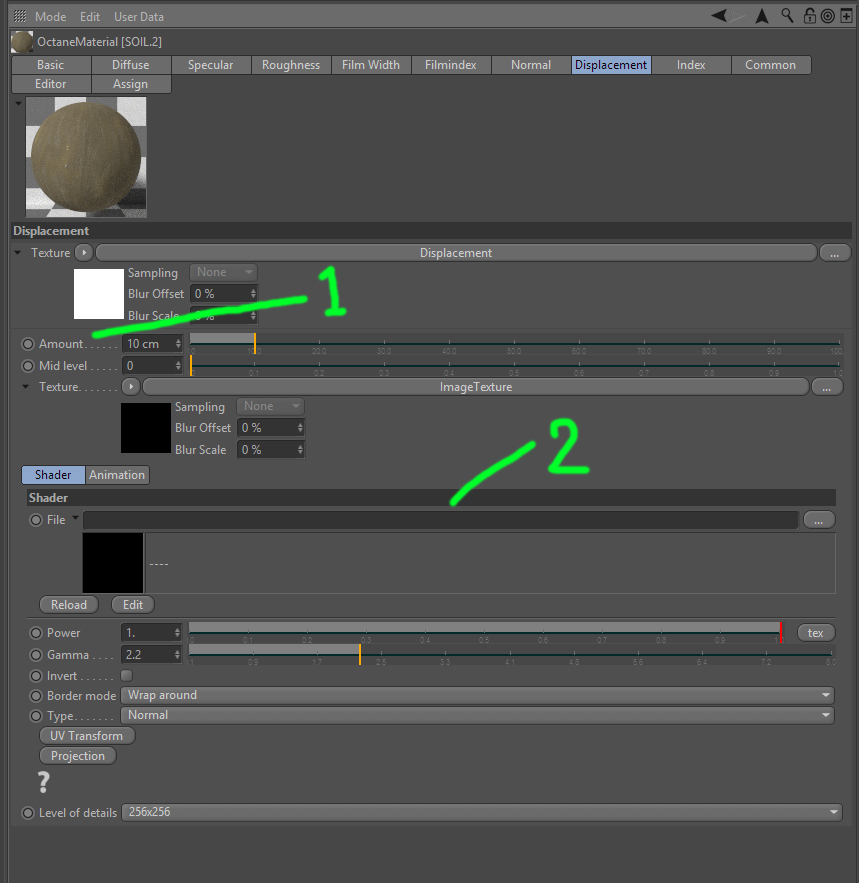

If I load a texture in FILE (2) the AMOUNT (1) instantly drops to zero, and then when entering a number in the AMOUNT, as soon as I hit enter, the texture unloads itself.
Similarly with Volumes when loading something in Absorption/Scattering/Emission, the DENSITY drops to 0.00001. And if raising the value, whatever you just loaded simply unloads itself.

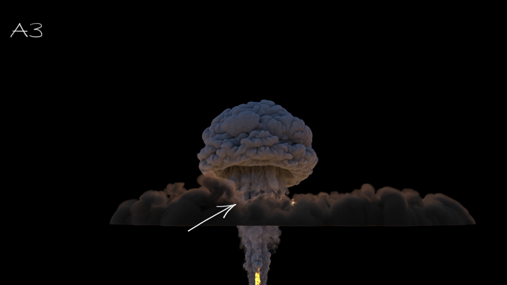

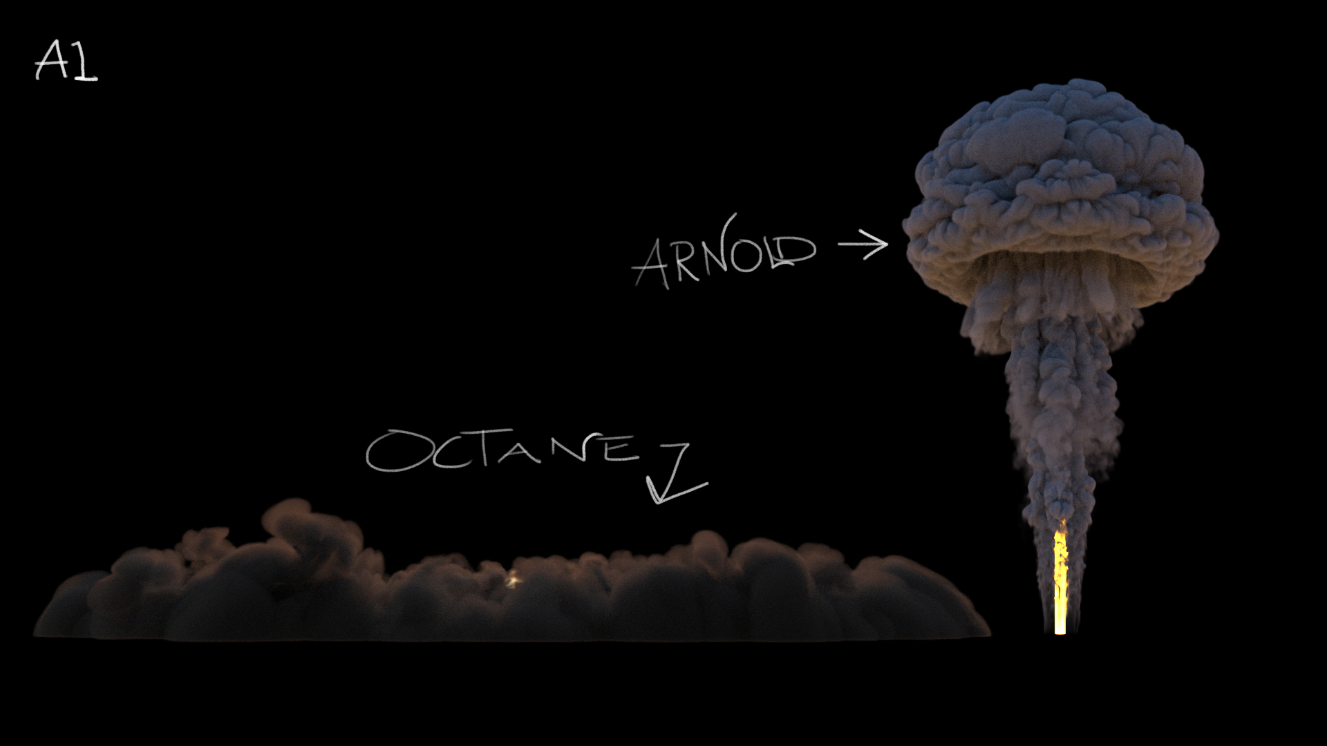

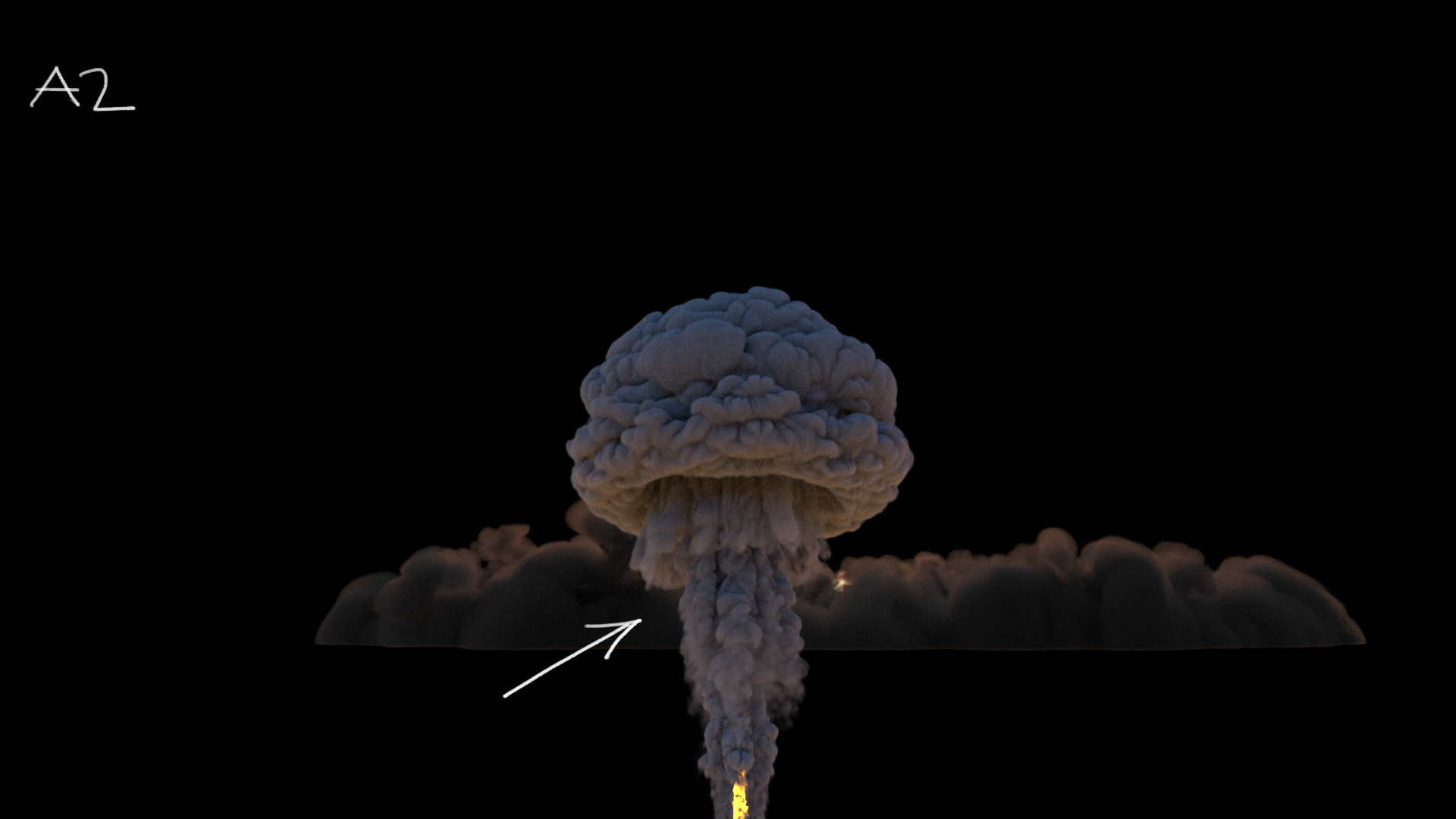

Octane doesn’t seem to produce a correct straight alpha channel
Example TFD sim
One rendered with Octane and one with Arnold
Now if I put Arnold on top I get correct result
But if I put Octane on top I get this white fringe/halo-thing

1. the good news is that Cinema4 R18 doen't have any issue with sliders, the bad news, especially for Ahmet that has spent a lot of time trying to find a workaround, is the issue comes from c4d SDK.

in the camera imager you have several options about Alpha channel, one of them is "Disable partial alpha", give it a try ;)

1. the good news is that Cinema4 R18 doesn't have any issue with sliders, the bad news, especially for Ahmet that has spent a lot of time trying to find a workaround, is the issue comes from c4d SDK.
Then why does it only happen with Octane? And the sliders aren't the biggest problem, whatever slot that got cleared usually takes a bit longer to recreate..

6. sorry but the vdb test it doesn't have much sense to me :roll: the octane material is completely different with far low density
Ok, I'll try that
