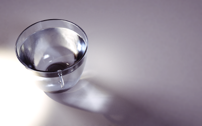

itsallgoode9, do you have a reference example of the wine punt, like you would want it to have?
The images you made already look pretty solid.
But yes, just an hdri won`t do the job if you are looking for way more defined caustics. Adding an (hidden) emitter does the job.
And rendertimes go high on pmc....this one took around 5 hours on 2x580 with RR enabled. Though I used an .ies for this one, so it`s still noisy.

The specific issue I tend to have problem (which is a bit different than your image) with is when light has to enter, exit, reenter, then exit the same liquid/glass volumes...sort of a rounded "W" shape. Here's the example below:
I was actually having some extremely extremely odd results this weekend regarding this but I need to do some more testing on other scenes and make sure I didn't just do something wrong in the setup on my specific scene.
