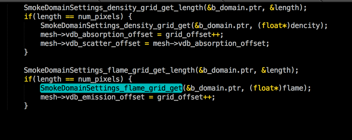

This is the Blender code (Octane-specific) you can see on GitHub: You see here that Octane module uses the Blender's function to access the "flame" channel, and it uses this channel as Octane's VDB "emission" channel. But as I said - Blender Foundation's
SmokeDomainSettings_flame_grid_get()
function always returns the empty "flame" channel for "Domain" type smoke. At the same time SmokeDomainSettings_density_grid_get()
works OK and returns actual "density" grid data (used for Octane's scatter and absorption channels).So, we need to wait before it will be fixed by Blender developers... I could implement this functionality instead of Blender developers, but I can't spend resources developing Blender itself, I only do anything regarding Octane support in it... If I developed this Blender's functionality myself, after Blender developers do the same in the same parts of Blender - merging with a new Blender versions becomes a nightmare 'cause the same functionality in the same Blender files will be developed differently...

There is no "alignment" needed... They just need to make the
As I see currently in their code - the "Domain" smoke object generates the "heat" grid, and this grid is saved to VDB cache. But when it reads this cache (before rendering), it checks and only reads the "heat" channel if the smoke has any other type than "Domain".
So, the "flame" grid (which is supposed to be filled by this "heat" channel data) remains allocated, but not filled in (all values are zeroes) - so when Octane module calls
So, this looks rather not like a Blender's "bug", but rather like not finished development of this functionality... Where they have made this channel generated for "Domain" smoke, saved to VDB cache, but still not read from this cache to make the
function working.
, it just returns this empty "flame" grid...So, this looks rather not like a Blender's "bug", but rather like not finished development of this functionality... Where they have made this channel generated for "Domain" smoke, saved to VDB cache, but still not read from this cache to make the
working... This is not just one place in Blender's code where "the bug" could be fixed, this is spread all over different code places as "not finished" code which leads to the consequence that SmokeDomainSettings_flame_grid_get()
reads the empty "flame" grid... I don't have a time currently to check if they have already finished this in a trunk, but I hope they will do it at some stage...- regionfive
