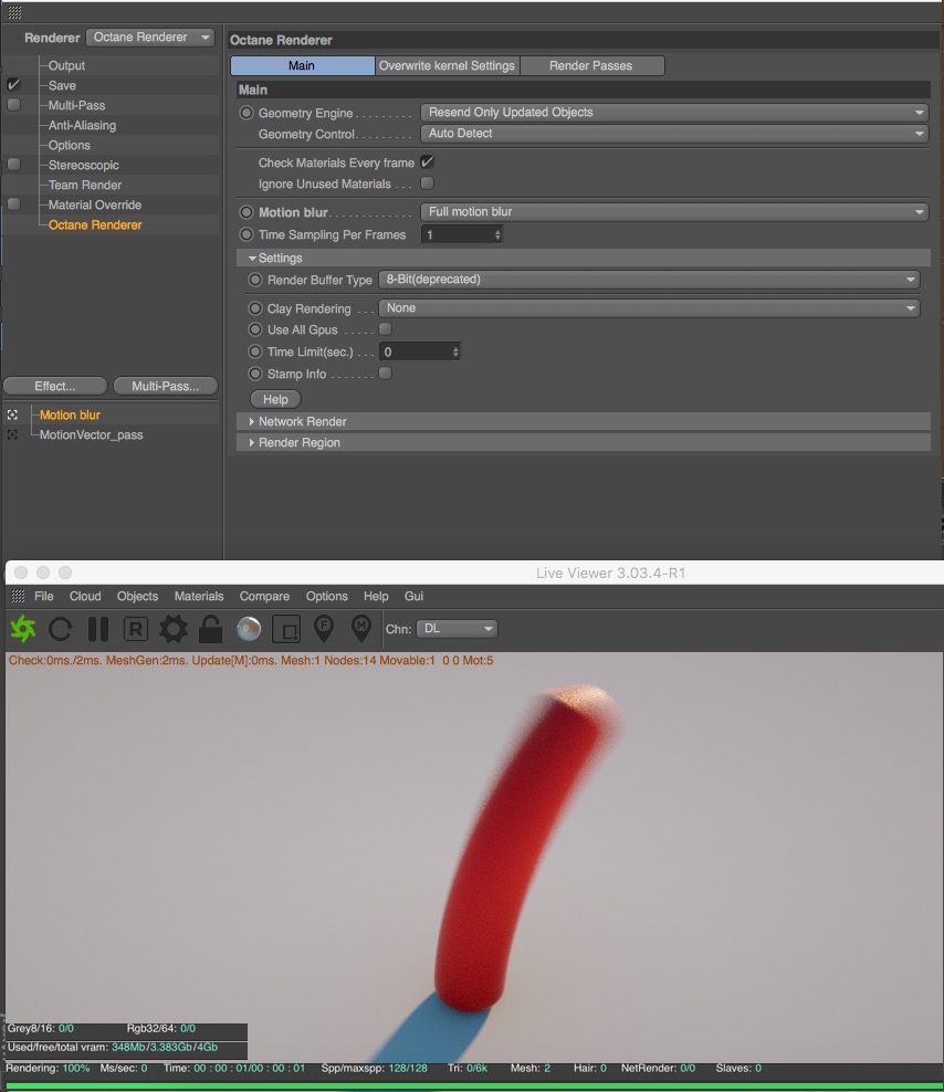

start by activate the motion blur in the camera tag, in LV and PV.

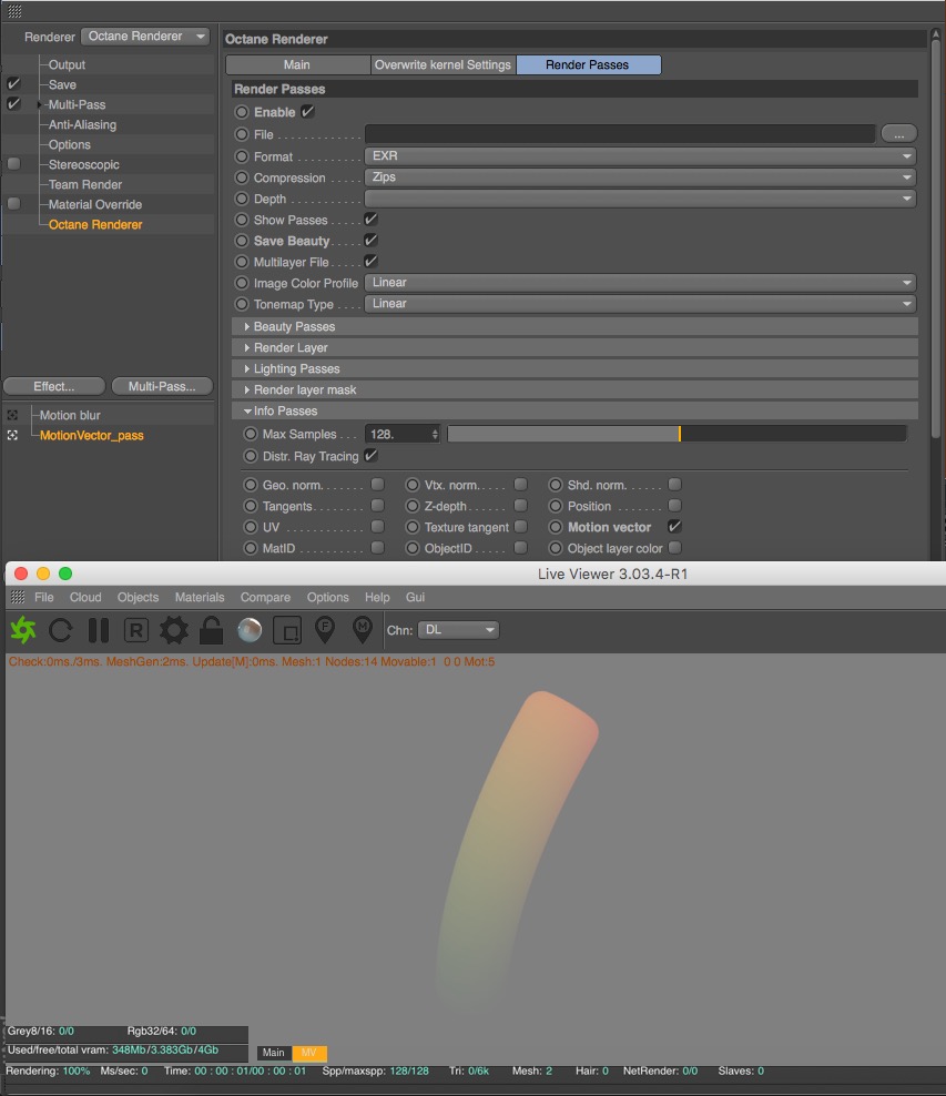

When you are satisfied by the effect, enable the info render passes / motion vector pass, the motion blur should have been automatically disabled and you should see the gray background and the colored motion vector.

just switch between the two render settings and reload the scene in LV:
normal motion blur
motion vector
