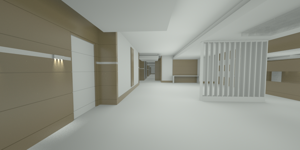

The issue is with the wall light on the left of the render. When it is on by itself (no other mesh light materials) then it works fine.(this was a quick render so quality is low)

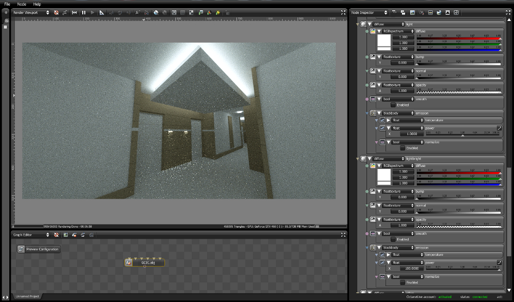

Now the scene has many lights which has made me create more then one light material within Octane. For the wall light I had to put the power of the texture emission to 500-1000 to get the intensity needed, then the ceiling bulkhead lights are another material with a texture emission at 5. Firstly I find this strange at the vastness of intensity these materials.
As soon as the 2nd material (bulkhead light) are changed to a mesh light then you can see the result in the Image 2lights_3min_direct. The wall light just disintergrates.

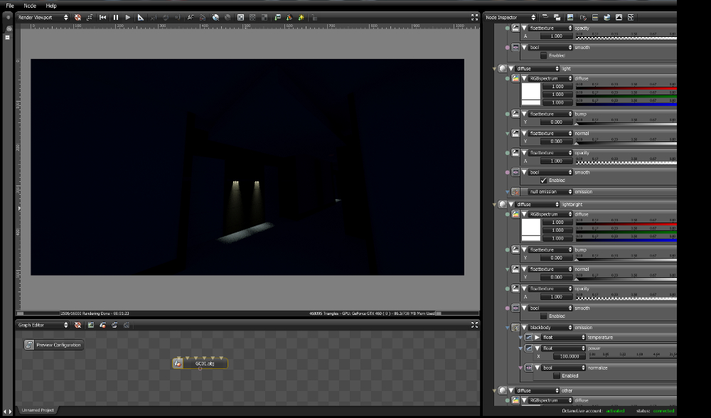

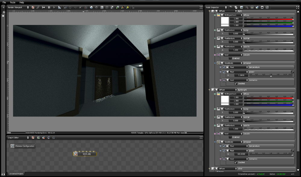

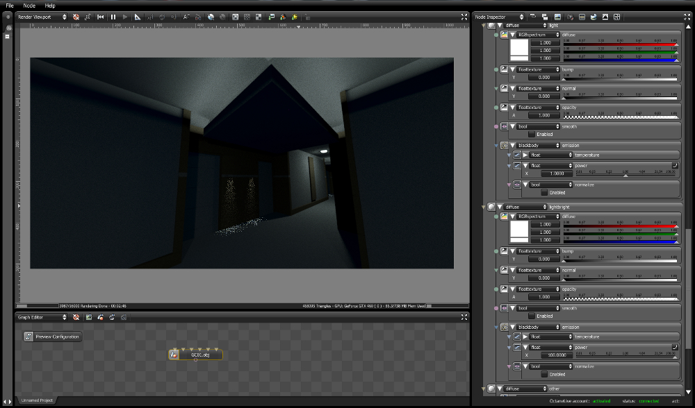

1 light material with normalize off using Directlighting
test01_1light_direct_off
2 light materials with normalize off using Directlighting
test02_2light_direct_off
2 light materials with normalize on using Directlighting
test03_2light_direct_on
2 light materials with normalize off using Pathtracing
test04_2light_path_off
Windows7 64bit / Intel core I7 2.8GHz / 6GB DDR3 / Gainward Geforce GTX 460 / Blender 2.5

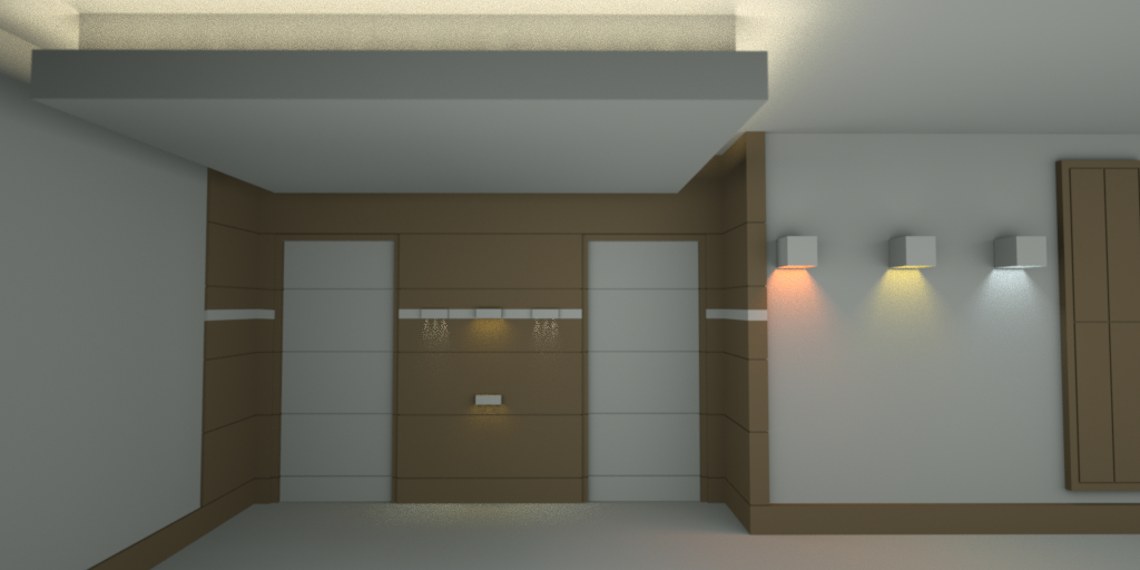

@Kubo: Yes totally understand, direct lighting is basic but in terms of Time vs Quality, time wins this round. So I am having to have a lower realistic quality but will able to finish on time. I also downloaded the latest version of Octane(I was using 2.4 and now got version 2.44).
Well I have been doing many tests today to find a solution to the problem.

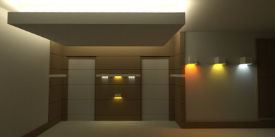

What I have found is that very small emitting mesh lights really lack in quality(I am trying to simulate LED lights) . If you look at the render the 2 lights on the brown wall opposite the orange light on the silver strip. They have 100% power and look at the brighness of it! The orange light in between then has a power value of 10 and is brighter then the 2 lights, I cannot rap my head around how this is happening.
I understand that octane is simulating real light properties but I am just not able to get the required results. I will just have to keep testing and wait until Refractive implement IES lighting.
If anybody has any ideas or solutions for interior wall lighting that can "fake" ies lighting please let me know.
Direct_multilights_1min

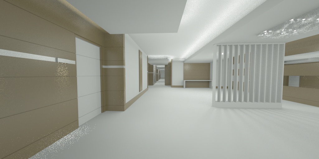

Just a quick update.
So below is the render that I left on after work on Friday.
Render time is 8 hours 54min
Max Depth is 32
Max Samples is 64000
Pathtracing
Pathtracing
Rendertime is unrealistic for large size renders but hopefully I can find the time to do it as the quality is a lot better then direct lighting except the noise interior scenes create.
