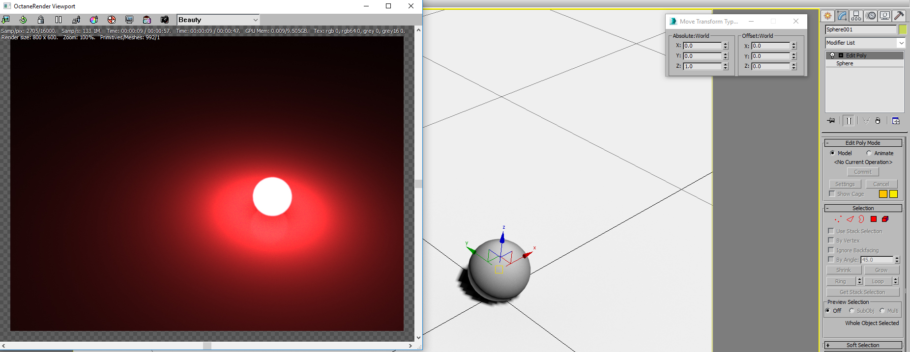

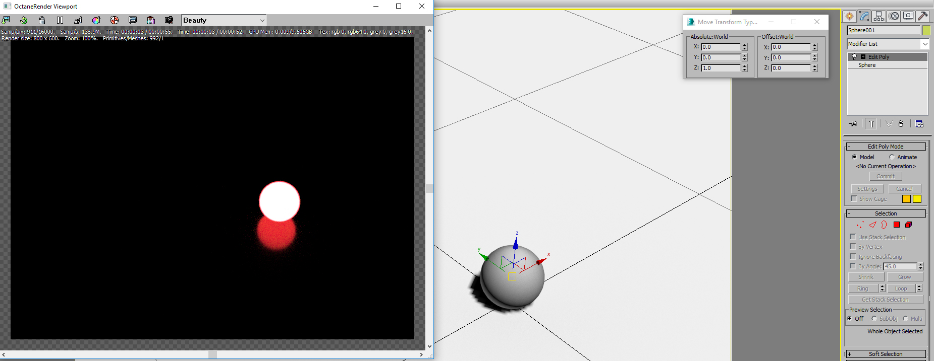

It's pretty easy to reproduce.
Create a sphere, apply a self illuminating texture using black body emission. Render on a flat plane so you can see the light spill out onto the plane.
Mirror the sphere, and the light stops emitting. Sphere normals are correct and the sphere shows illuminated.

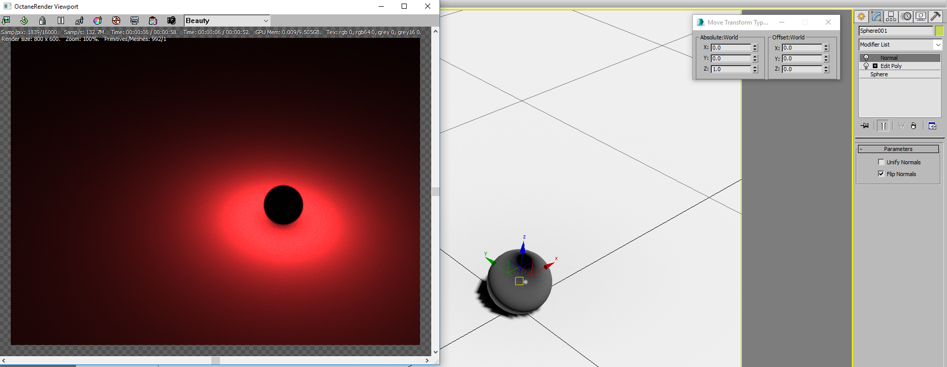

Try flipping normal and the light emits, but now the sphere normals are reversed and the sphere is not illuminated.

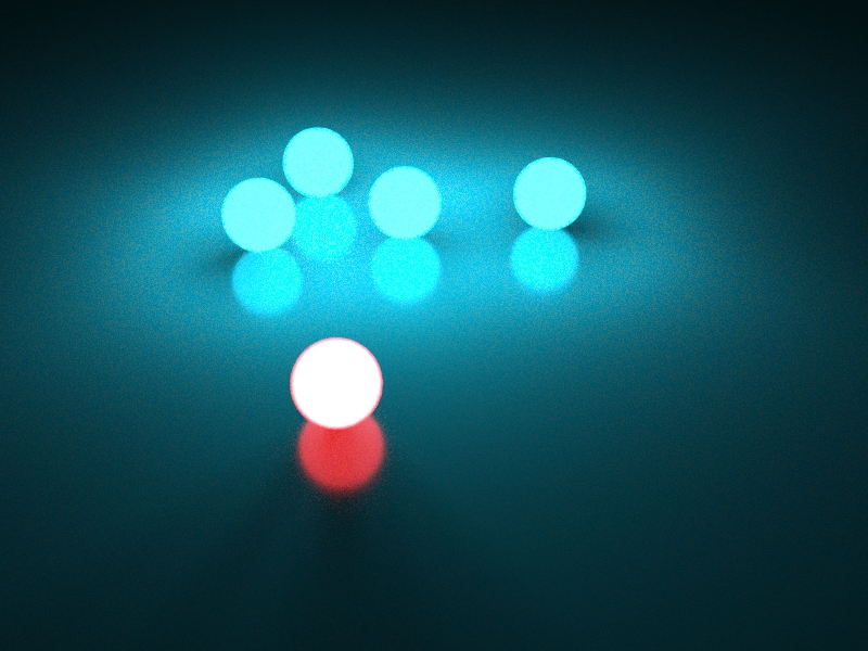

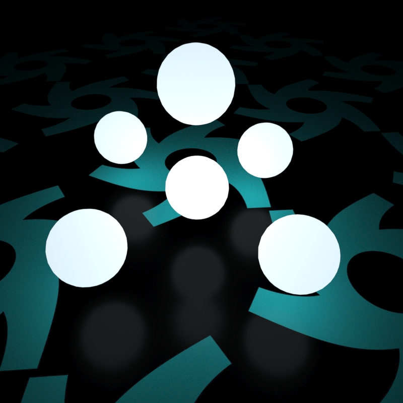

Hi paride4331, thank you for taking the time to take a look, I must sound like a crazy person when I'm the only one experiencing this issue
This is really strange, I am noticing some odd behavior in the file you uploaded.
The first thing I noticed is that in the Octane render viewport, if I move my sphere around I have to refresh the Octane viewport to see it move. However if I move the spheres you created the Octane viewport shows them moving in real time, without having to update the window.
If I just simply mirror my original sphere, I get the same effect as I did before.
If I mirror your spheres, they work just fine, and in fact update live in the Octane window. If I make a copy or instance of your sphere while mirroring it works just fine, and updates live in the Octane window.
I would love to know why the spheres you created are updating live in the Octane window, and are functioning correctly. Every sphere I create has the same problem when mirrored, it is a little frustrating.
