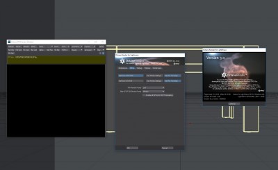

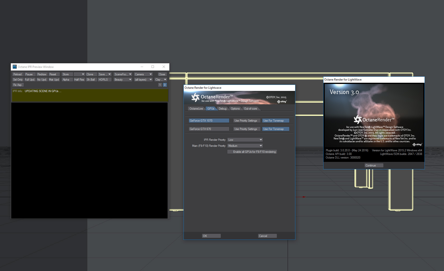

I can run it fine with my gtx670, but when i try with my new GPU it stops when trying to update GPU in octane.
Check out screenshot.

You are not using the latest plugin build available. The one that you are using is not compatible with the new Pascal GPUs.
Please, download the latest build (3.03.3.0) that you can find in the forum top announcements topic:
viewtopic.php?f=36&t=55760
