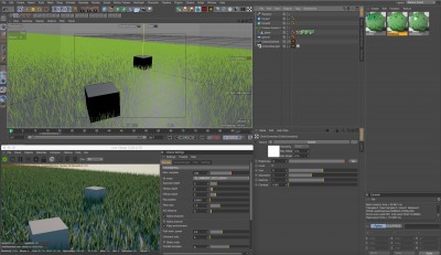

Cause of client i made test scene.
scatter_grassTest.zip
test file
(80.5 KiB) Downloaded 386 times
The boxes is dummy for houses as scale reference. I know this scene dont represent real world scale, but i guess in terms of density of grass that doesnt matter

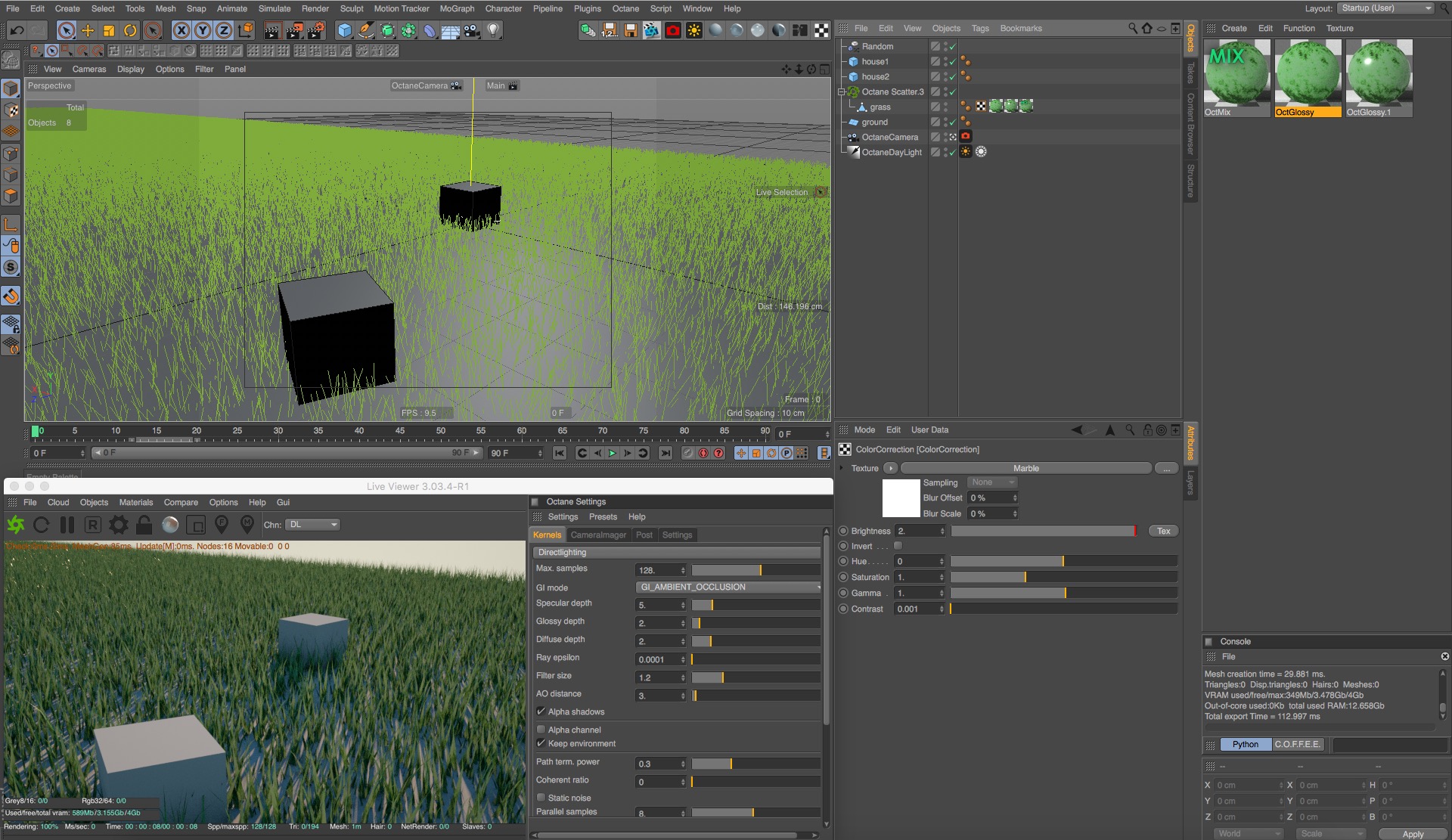

Posts: 10646
Ok that the scene scale is not accurate, but the objects inside the scene should have a correct proportion.
The pivot of the sigle blade of grass has a great importance as always.
Here is a modified version with a Mopgraph Random effector:
scatter_grassTest_0001.c4d.zip
(140.55 KiB) Downloaded 495 times
I have also revisited your material replacing the c4d shaders with normal Octane shaders.
ciao beppe
