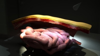

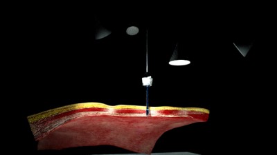

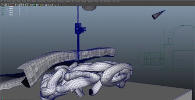

IPR/Octane 2.24.2 is behaving strange. and I'm not sure why.
The IPR won't update with all of my objects turned on. I'm trying to render a heavy Stl model (2.8 mil triangles from Solidworks) over another model low poly model with a 4K displacement map. Both seem to render fine separately however rendering then together just won't happen. The IPR doesn't update from the snapshot.
I'm feeling as though I might be having either memory issues or there are setting that I need to work with to allocate more resources.
I've been hacking away at this all weekend and have hit a brick wall. Any help would be greatly appreciated! Btw, I've already changed all geometry types to "moveable proxy"
Scene poly count: 2.9mil faces

Hi RyDarling,RyDarling wrote:I'm trying to render a heavy Stl model (2.8 mil triangles from Solidworks) over another model low poly model with a 4K displacement map. Both seem to render fine separately however rendering then together just won't happen. The IPR doesn't update from the snapshot.
First of all, I can see on the rendersetting screenshot you're using an old 2.24.2 plugin maybe 2.24.2- 7.14, you should use the 2.24.2- 7.24 which is more stable.
I remember also having strange IPR updating with scene involving displacement.
To debugg your scene :
keep only the two objects in a new scene.
On the displaced model start with a lower res for displacement (512x512 for example),
and on the STL object apply a polygon reduction, mesh>reduce, (starting at 90% for example).
Does the problem still occur ?
if yes,
the problem is not memory relative.
If not,
- progressively increase the displace resolution to find out when the problem start to happen.
- and/or progressively decrease the polygon reduction to find out when the problem start to happen.
