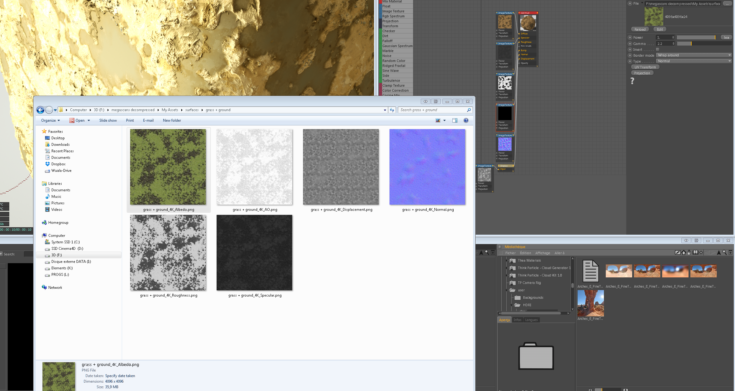

I want to use node editor to create quicker texture materials but Ican drag a map in the node but it's not appying to my material.
If i do it by material inputs with paths,it works.
Do you know that ?
Is there something i do wrong ?

What do you mean exact? Drop images and connect to input pins. That's the way

I undestand but just replace an existing picture directy by another one doesn't work.
The drag and drop works and create a new image texture.

Are you sure? That was working when i check but it just doesn't refresh preview and gui immediately. This refresh issue fixed on this test build: viewtopic.php?f=85&t=56169#p288387

It works with ... button but nope with drag and drop.
Not really important.
