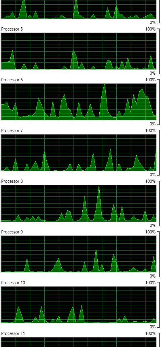

According to Paul "the plugin will extract all the geometry from ArchiCAD in a single thread, load that info into Octane in a single thread, but then Voxelize the data using multiple threads."
So, for that one thread an i7 core can be more interesting then two Xeons.

the link to the other post (link above) .shows images of threads used while doing calculations.. might be interesting to read. You find one image here too.
