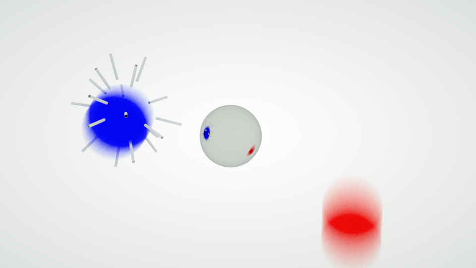

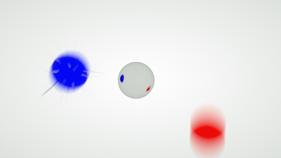

Hi Guys,
Quick fix if is possible for the Maya plug 7.24 Please :)
Motionblur with hair is not working only on standalone. here some images and scenes. :shock: :o
Very best,
JO

Maya
Maya

Standalone
Standalone

Jolbertoquini
Posts: 1067
Joined: Sun Aug 31, 2014 7:08 am
Location: London
Any news Guys....I add attach all files???? Can we have some answers, Please?

calus wrote:As a workaround in Maya, you could use subframe motion bur...
it's never work for me to... it's working for you ?
for me in any condition doesn't work.

calus
Posts: 1308
Location: Paris
Jolbertoquini wrote: Really works only in batch render??
Just to be sure I was clear,
the internal motion-blur doesn't work at all for hair, I think it was never implemented,
but the subframe motion-blur works,
obviously subframe motion bur can't be previewed in IPR because of the way it works (blending prerendered subframe together).
Pascal ANDRE

hello everyone :)
@Jolbertoquini - Thank you so much for uploading sample files.
@calus - Thank you for posting this issue the other day.
We have implemented the internal motion-blur with nhair and it can be previewed in IPR !!!
Please review our latest OctaneRender for Maya® 2.26.1 - 7.20.4 Build - [ viewforum.php?f=109 ]
Your input is always appreciated.
