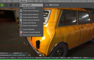

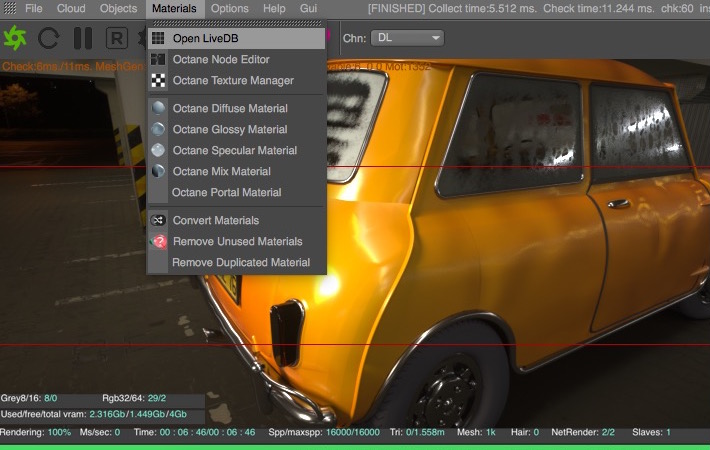

About the LiveDB access, in a saved scene and and loaded in Live Viewer, go to Materials/LiveDB:

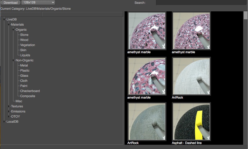

a new window will be opened where you can find and download the LiveDB content and also have access to the LocalDB section:

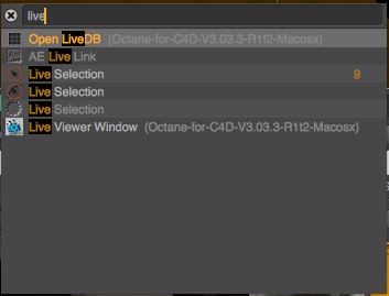

Hint: you can press shift+C and tipe livedb to easily find the command:
