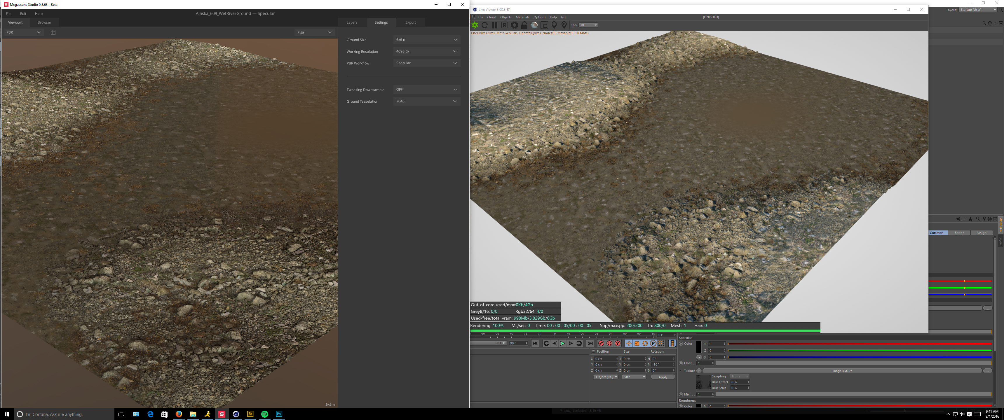

I'm sure its an user error on my part but I'm using Octane 3 for Cinema 4d and when I plug in my textures I'm not getting the same results I see when I'm building in Megascans. Does anyone have the proper workflow to get the same results in both?

From what i've gather online looks like right now megascans studio is exporting at 8bit instead of 16bit which they are aware of and are fixing

yup, I'm getting nasty 8bit banding in the displacement maps.
These are helpful if you want to match the lighting from Quixel.
http://support.quixel.se/hc/en-us/artic ... ed-in-3DO-

This guy has been getting some nice results with whats available he said he'll make a tut to show how hes been able to do it
https://www.artstation.com/artist/randoff
