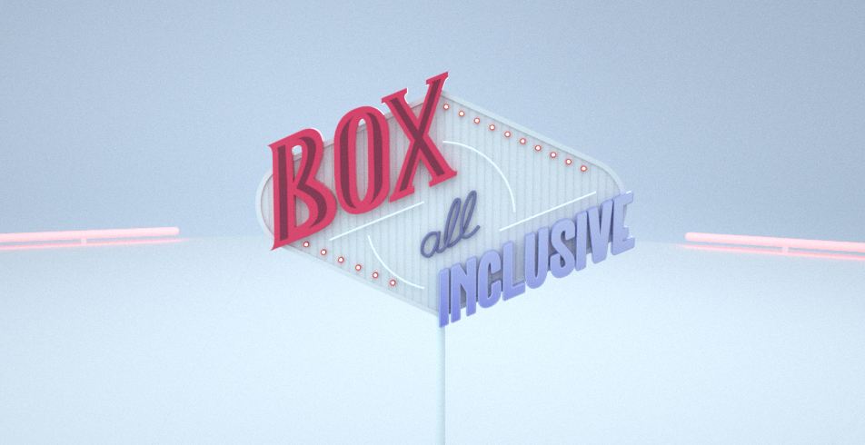

This one is from the picture viewer (frame 1)

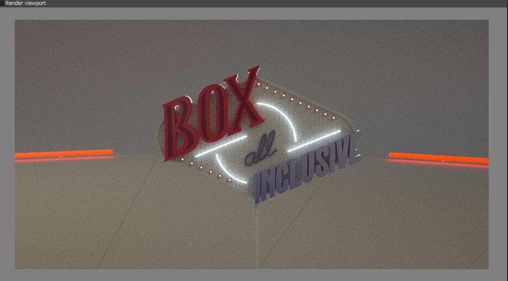

This one is from the standalone, when I exported the orbx (frame 1 too):
It's really annoying, I don't know what to do.

Are you on 3.03.3-R1? If so please send me you scene. I'm gonna try that.

I see you have animated light tags on first quick check. Export orbx is not yet supporting animations for materials or tags. Can this be your problem?

Yes I have animated different light tags.
Have you got any solution to avoid this problem ?
Posts: 16068
Location: Türkiye
FxDesign wrote:Yes I have animated different light tags.
Solution is to wait until we add this support.
