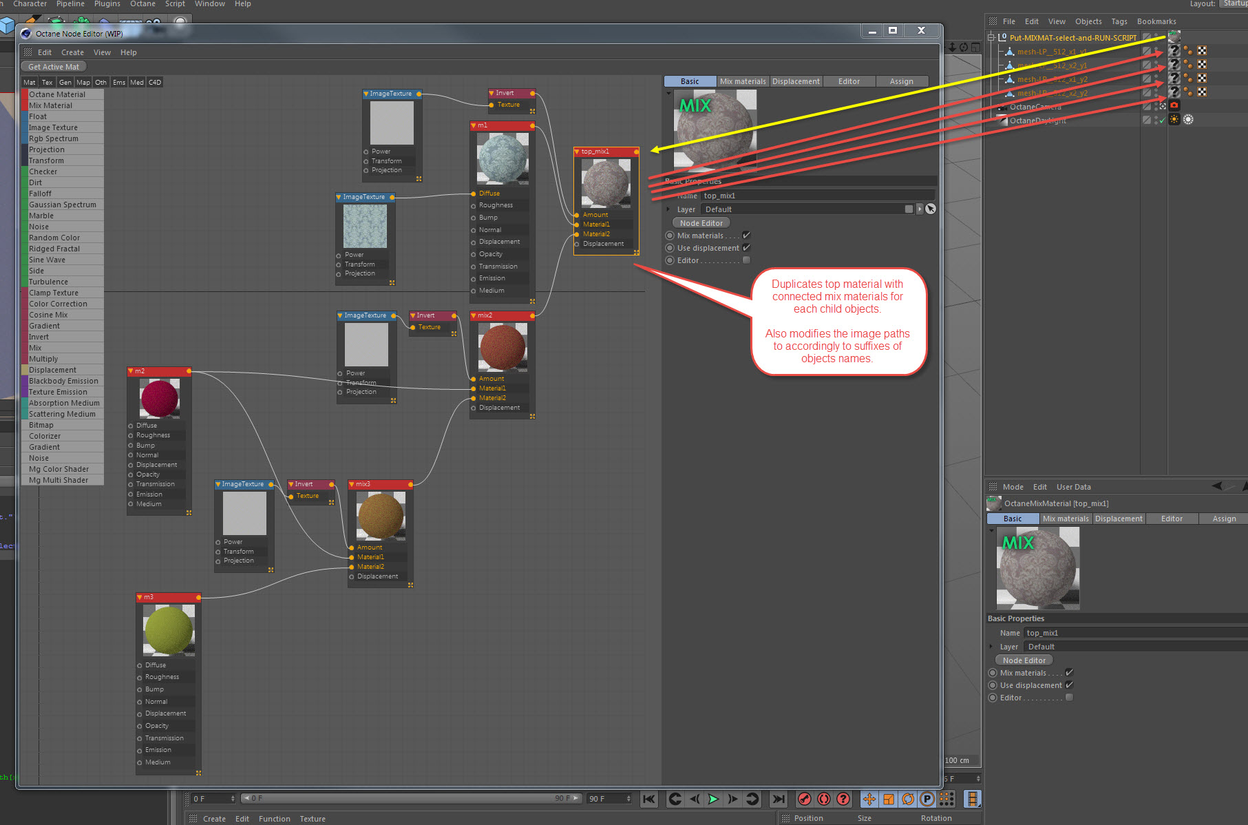

This is a special script. It includes an example scene and description. See attached image.
Also this is very good example to show how you can create, connect and modify Octane materials and images.
clone_mix_network_modify_amount_imagepaths.zip
(211.52 KiB) Downloaded 4850 times
