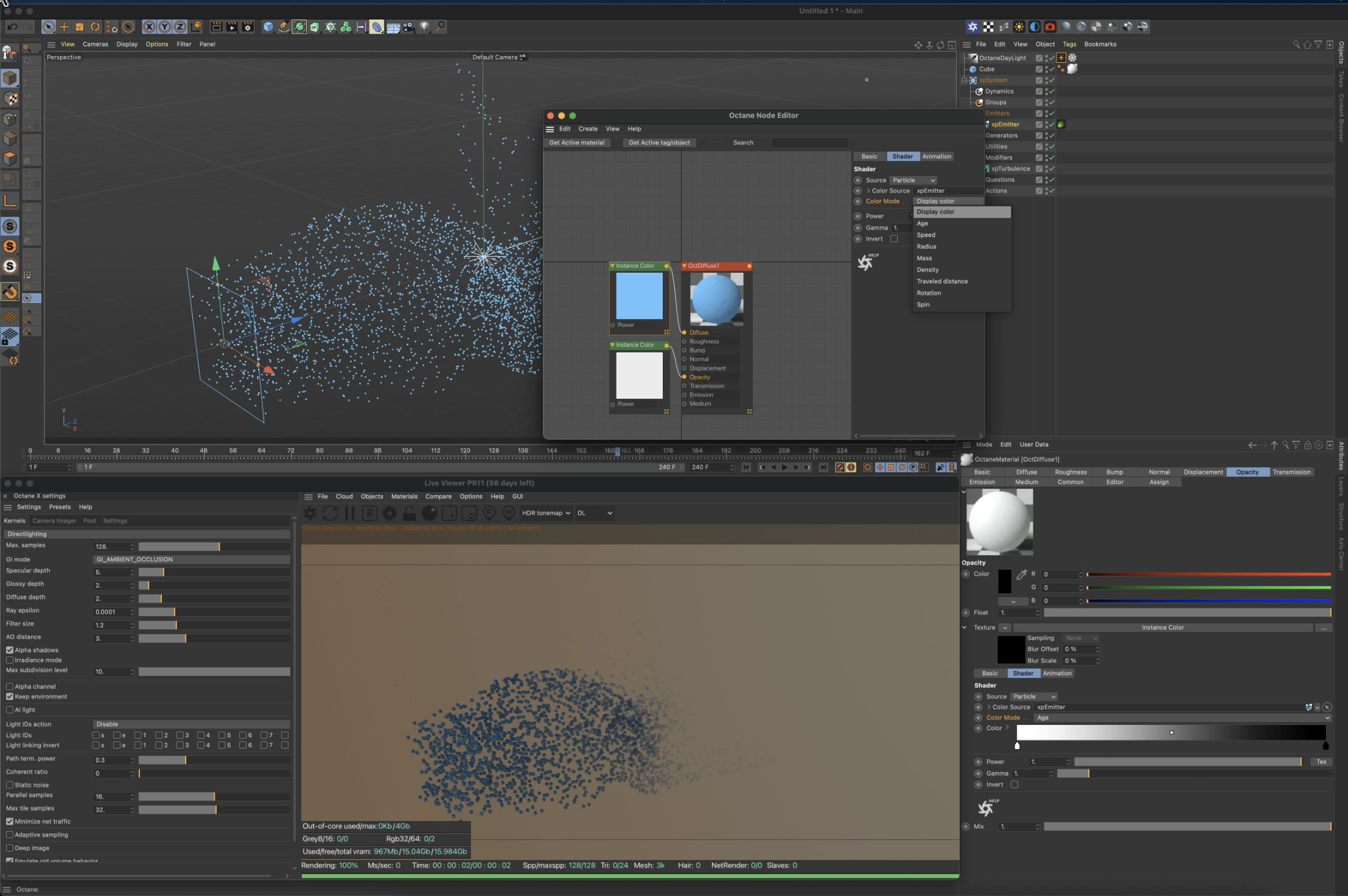

from some time, we have the Octane Instance Color node:
https://docs.otoy.com/cinema4d/InstanceColor.html
You need to change the mode from File to Particles, and drag and drop the XP-Emitter in the proper field.
Then you can choose between different modes, for example Age, set the gradient from White to Black, and connect it to the Opacity channel of the particles material:
And you can use the Gamma, or modify the Gradient, to fine tune the effect.
ciao Beppe
