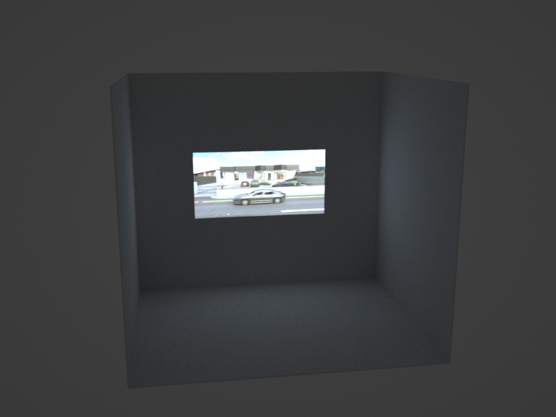

Thankyou for this explanation. I'm still having a problem however. I can get the image to project but it looks like a spherical or shrink wrapped map projecting now
So I tried adding a slot to the 'projection' parameters and closet I can get is using 'box', however there is still distortion at the edges of my image. What projection did you use in your example?

Hi
The geometry is simply a small plane, casting onto another plane. I've only done it in Max as a test, so no project file. Everytime I do it the projection appears spherical mapped. You have to apply a node to the 'projection' slot to get anything looking normal. Here I've used Box, but there's still distortion at the edges.

here is the scene of projector lights in case someone needs it.
