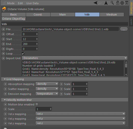

whoopsy figured it out afterwards... for those that would like to know. import first VDB frame. In properties, select the film strip icon, select the frames afterwards and boom...VDB animation :D

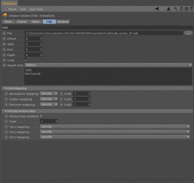

I am having the same problem here. I have a vdb sequence number smoke_0001, smoke_0001, etc. and the smoke_$F.vdb in the file path but nothing is showing up, I get the "vdb: not found" message. The vdb shows up when I select a individual file and render.

chanson78 wrote:I am having the same problem here. I have a vdb sequence number smoke_0001, smoke_0001, etc. and the smoke_$F.vdb in the file path but nothing is showing up. The vdb shows up when I select a individual file and render.
Is there any new documentation on this subject, the link is broken,
Set digits=4 because you have filenames like that and check log texts in vdb object if is it loaded. Adjust units until see yellow box.

Set digits to 4, still nothing.
This shows up in the log "cannot import a regular grid from an empty voxel buffer," I assume that is a problem.
Yellow box shows up only when I load one file from the vdb sequence and it also renders just fine.
What units should I be adjusting?

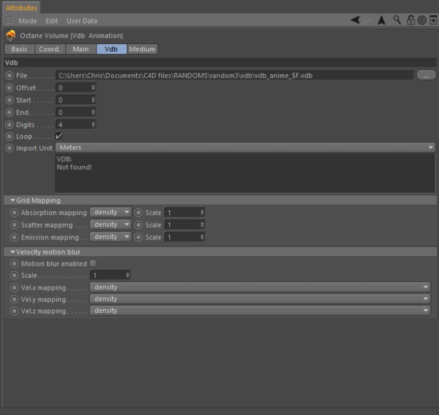

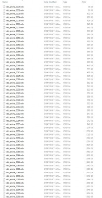

Please post a screenshot like this and also show how's your filenames from explorer window.
chanson78
Posts: 47
Joined: Mon Apr 25, 2016 2:24 pm
Here you go...

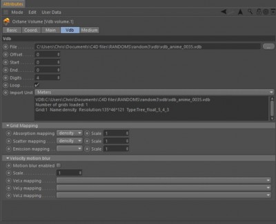

Just to show that its working with one file of the sequence...
