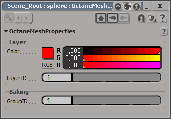

V3 will have a baking camera with which you can bake 65535 baking groups.
You can set the baking group id in a custom property for each object.
So you can also bake at pass1 backing group id 1, at pass2 id 2 and so on.
But it isn´t included so far, will be the next step after i have finished the image saving.
It should also work if you set for all objects the same id and work with render layers per pass.
Also baking camera from pass 1 will use layer1, baking camera2 from pass2 uses layer2 and so on.
Or you write an expression, where the last pass number will drive the camera shader baking group id, or over a custom property in each pass.
Theoretical ;)
The property is here:
http://vimeo.com/user2509578

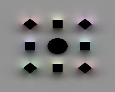

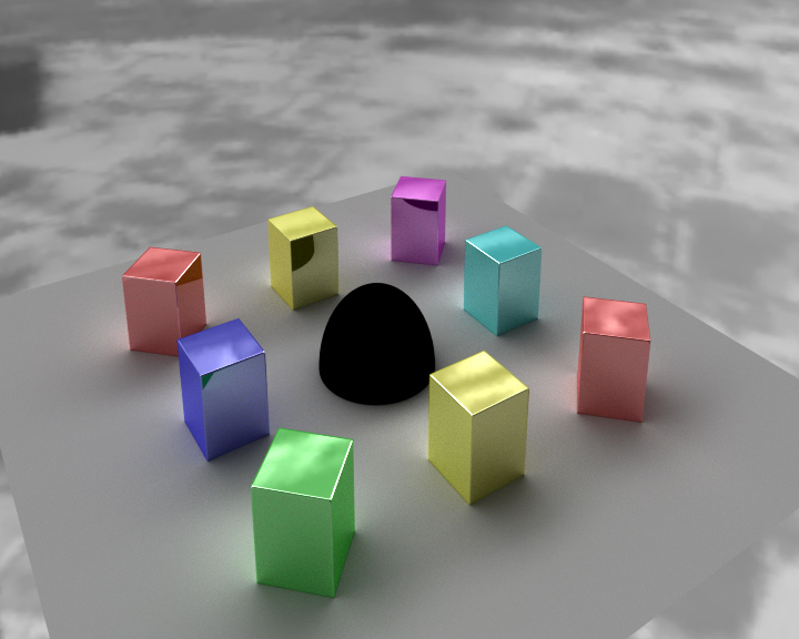

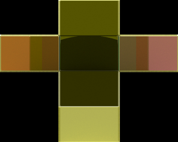

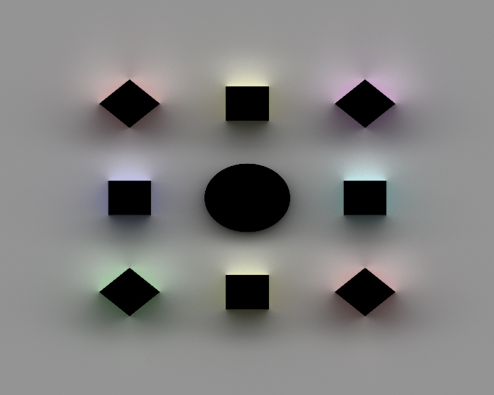

  1. Yes
    Original
    Original
    Baked cube
    Baked cube
    backed plane
    backed plane
  2. Hm yes, i can make a script which assigns a unique id, but how you will know, which object uses which id to bake it?
