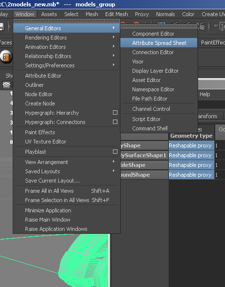

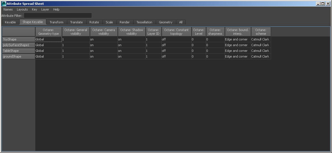

If you assign it to a button on the Octane shelf, you can use it to batch change the geometry type parameter.
Just select all the geometry you want to be Movable Proxy and click the button you created, it will be converted to Movable Proxy.
