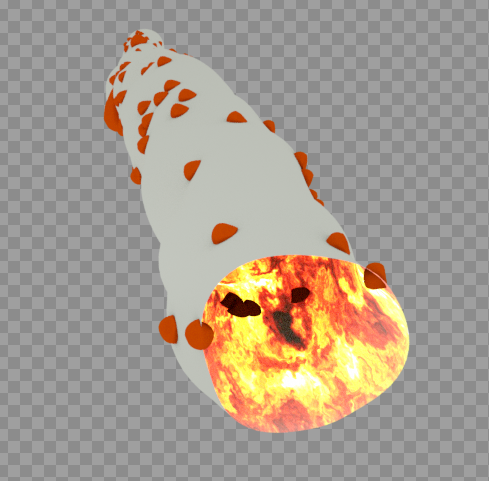

Sure, here's a screen shot of the rough mockup.
Its a tube of lava that the camera will fly through. I have rocks cloned along the tube. As you can see, the rocks showing on the outside get global illumination, so they're orange. But the rocks inside the tube are black because global illumination can't make it through the tube object.
So I was hoping to exclude the tube from global illumination in order to let the rocks inside be illuminated. Unchecking the "Shadow Visibility" in the octane tag doesn't help unfortunately.

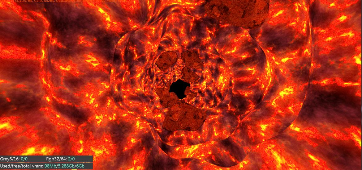

Which render kernel are you using, direct light or path tracing? Direct light will not work well for things that need to receive light indirectly. Also Have you tried making your lava walls be the actual light source? Technically speaking if this was a realistic setup, the lava itself would be what is lighting the scene and otherwise if it were me, I'd look for ways to get the lights inside of the tube.
Try playing with the attached c4d file. It's super rough, but should give you an idea.
Should look like this
