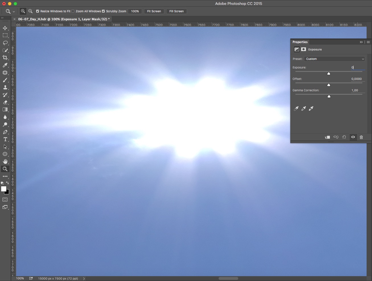

1. open the HDR in Photoshop

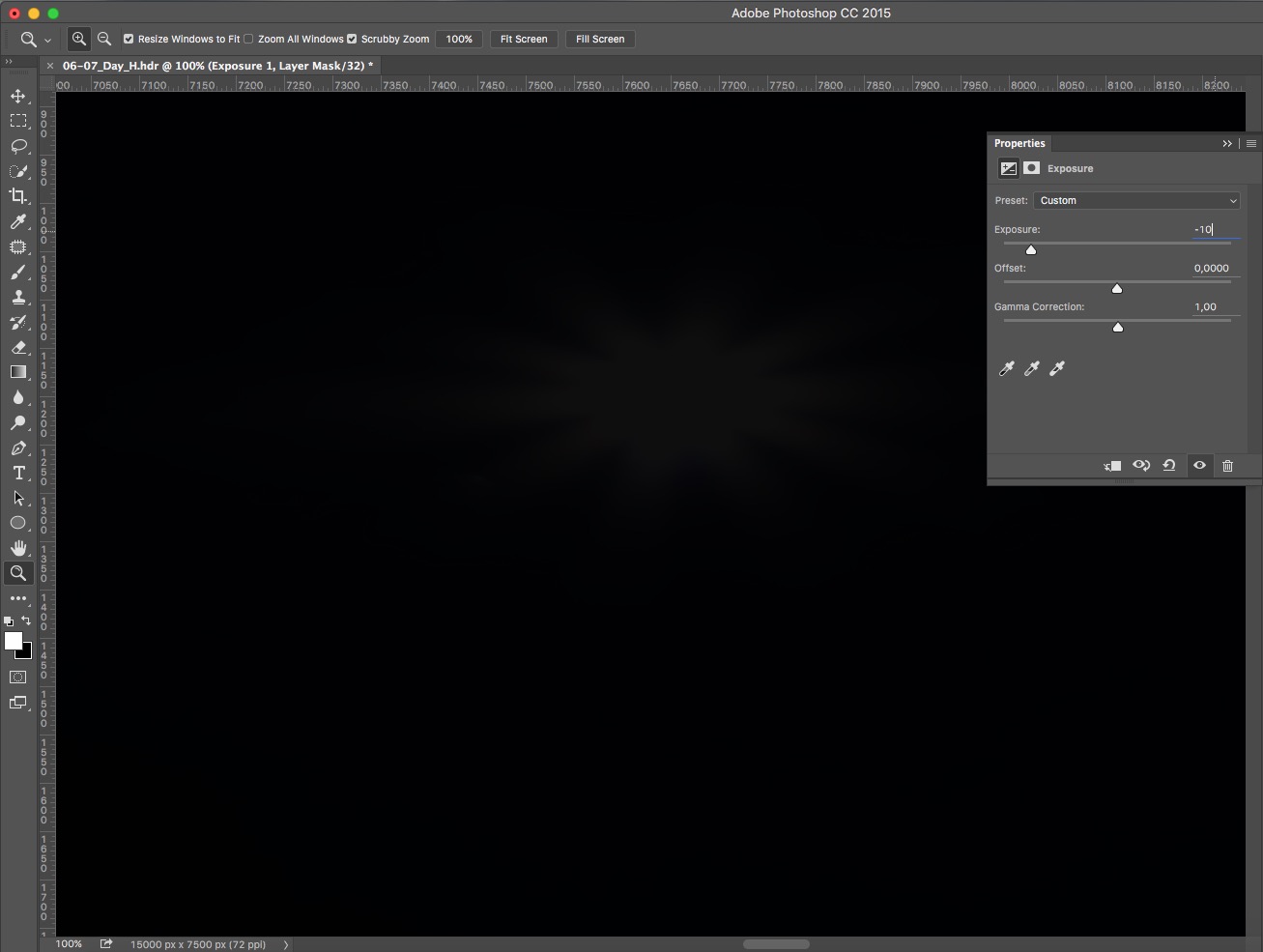

2. add an Exposure layer and lower the expsure value until the sun is still partially visible, in this case -10.

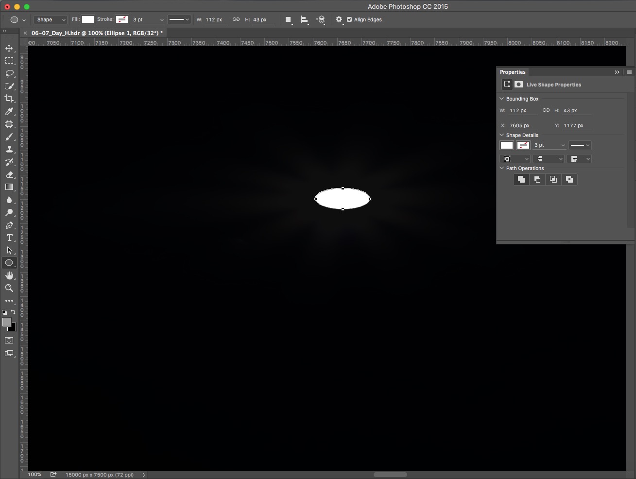

3. create an Ellipse in the position of the sun.

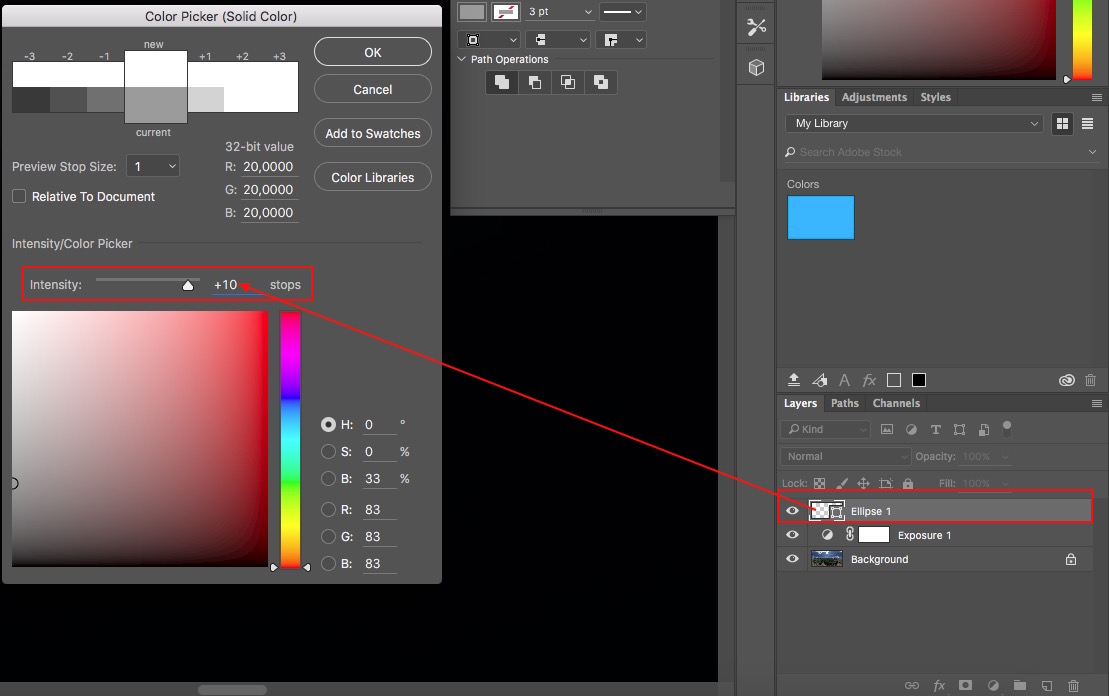

4. double click in the Ellipse layer and set the color as white with +10 exposure

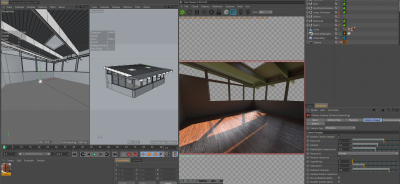

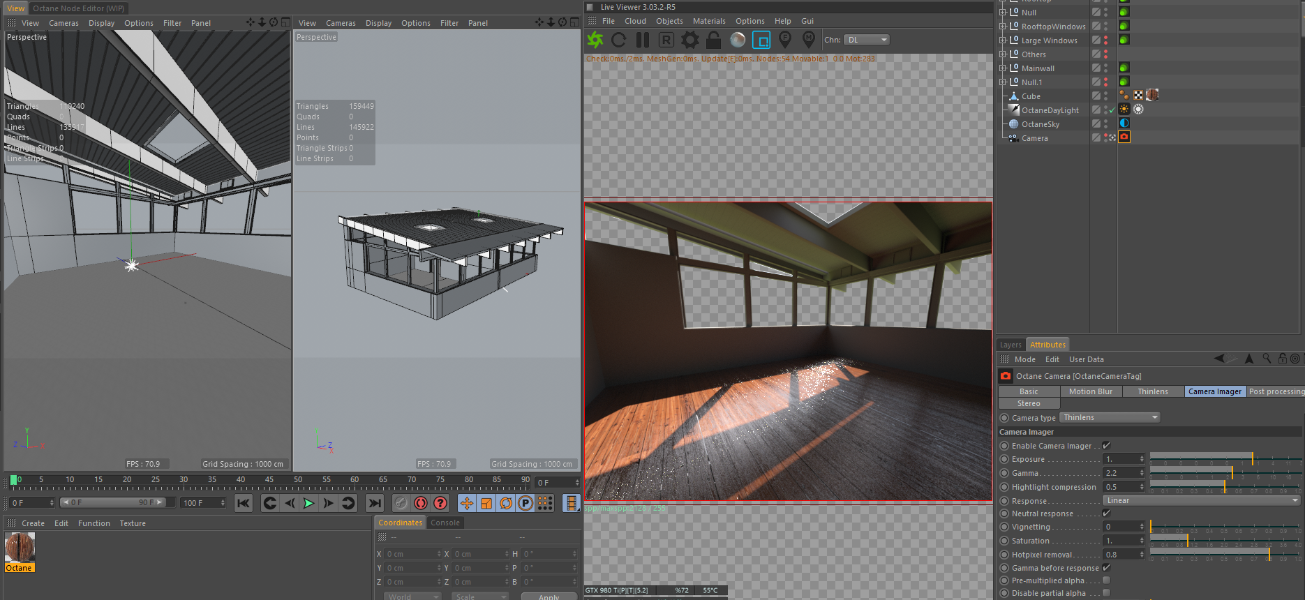

Hello ! Instead of creating a new thread I might just post my relative similar question here when using HDRI+Daylight in C4D V3.
Previous v2 some users stated it's not necessary to use HDRI with Daylight and portal lights isn't needed as well to lit the scene. However for the past weeks I'm trying to get a decent lit scene with the use of DayLight+HDRI without portals however no matter what the lighting in my scenes just feels too of. I've also tried opening more rooms for my lights to enter the scene but still it's very dark and used xpresso to bind the rotation of the daylight sun the sun from my HDR but it doesn't work. Here's some screenshots from a scene I'm currently working on.
*Note: I'm not an archviz guy but starting to get into it
EDIT:
Tried switching to PMC and it's okay but it's too slow for the LV.
Maybe it's because I'm runnning on just a single 980Ti...
Color Profile: Disabled<br />PT<br />Gamma 2.2<br />In my Octane Sky under Image Tex, the power is set to 5 and gamma of 1 for HDR
PT
Gamma 2.2
