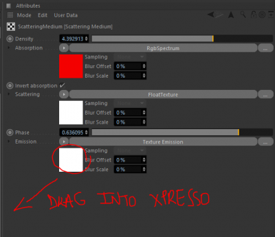

Hello,
I want to change an emission power parameter from xpresso, but when I add the texture into xpresso I can't find the parameter to link it.
Any solution? Thanks
JavierVerdugo
Posts: 97
Joined: Thu Sep 18, 2014 10:50 am

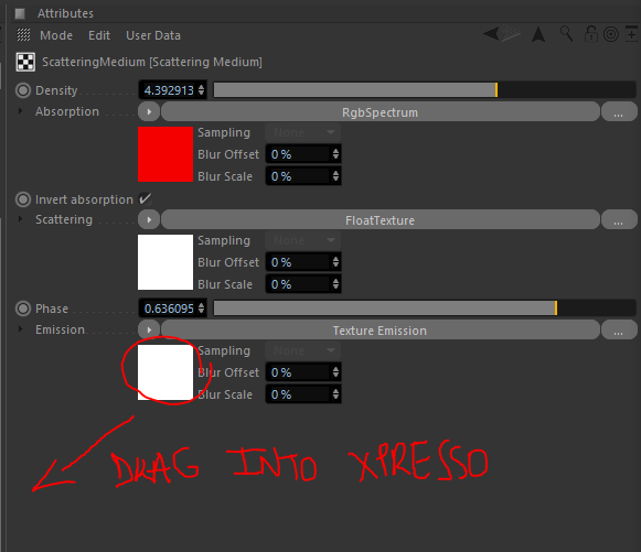

Hi again,
i answer myself and maybe someone find this useful.
If you add the texture inside xpresso you can't access to the Texture emission node, but you can instead add the texture emission node, just drag the white square of the texture emission (image attached) into xpresso.
Maybe are you programming a better workflow for this kind of stuff?

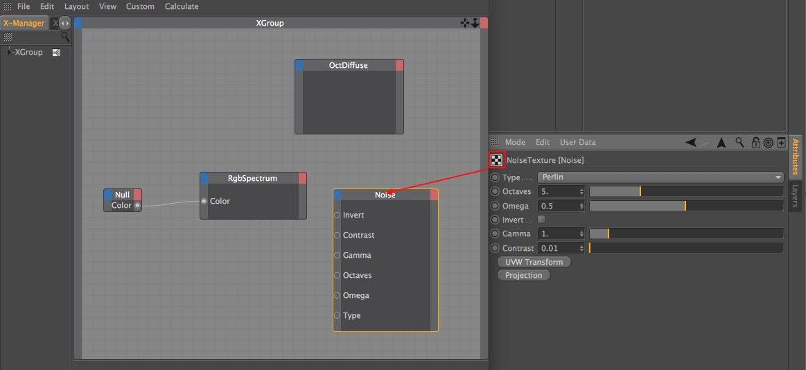

Hi JavierVerdugo,
in general, you can drag into the Xpresso window any kind of Octane node from the red marked area in the attribute editor, here is an example of an Octane noise:
ciao beppe
