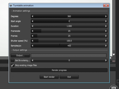

What you are looking for it seems more like a Camera orbits around a target. In Standalone, select the Render Target and go to Script/Turntable animation. In the new window you can set up the animation options:
Is this what are you looking for?

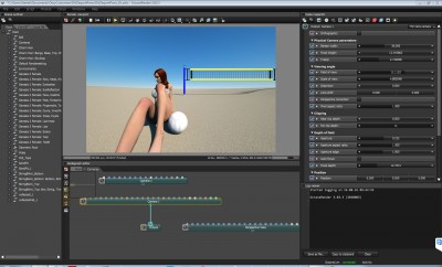

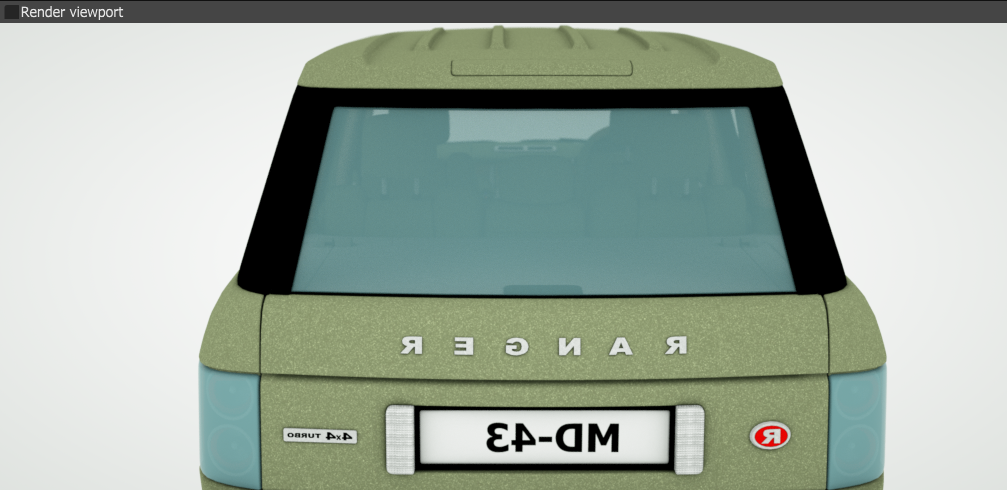

Then I zoom into the vehicle and set up the camera where I want my first person VR view to be i.e. in the driver's seat:
Image 2
Image 2

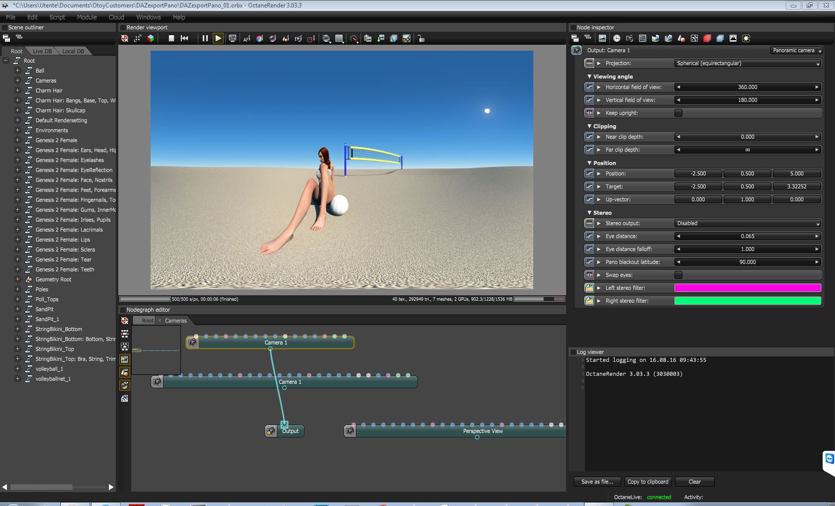

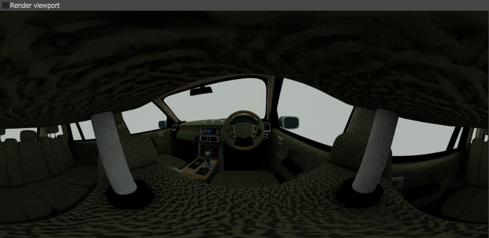

Now at this point I'm ready to switch to the Pano camera and do my VR render but when I do that the camera jumps back a bit i.e.
Image 3
Image 3
Now in this specific case I could easily zoom back in in Pano mode to the position where I want my eyes to be but on larger scenes the position of my eyes changes to such a degree that it is difficult or even impossible to have it back to where I aligned it while still in Thin Lens mode, partly because the navigation in Pano mode seems to behave differently than in Thin Lens. So what I'm looking for is when switching from Thin Lens to Pano that the camera position gets locked into how it is in the second image so that I don't have to manually readjust the scene before rendering.

Posts: 10564
Hi Riaan,
you can consider the Panoramic Camera as the largest wideangle possible. So zooming to find the position is not a good idea. What is important for Panoramic Camera is roughly only the position in space. In general, you can navigate in Pano mode by interactively changing the camera position in the node inspector.
ciao beppe

Posts: 10564
Hi Riaan,

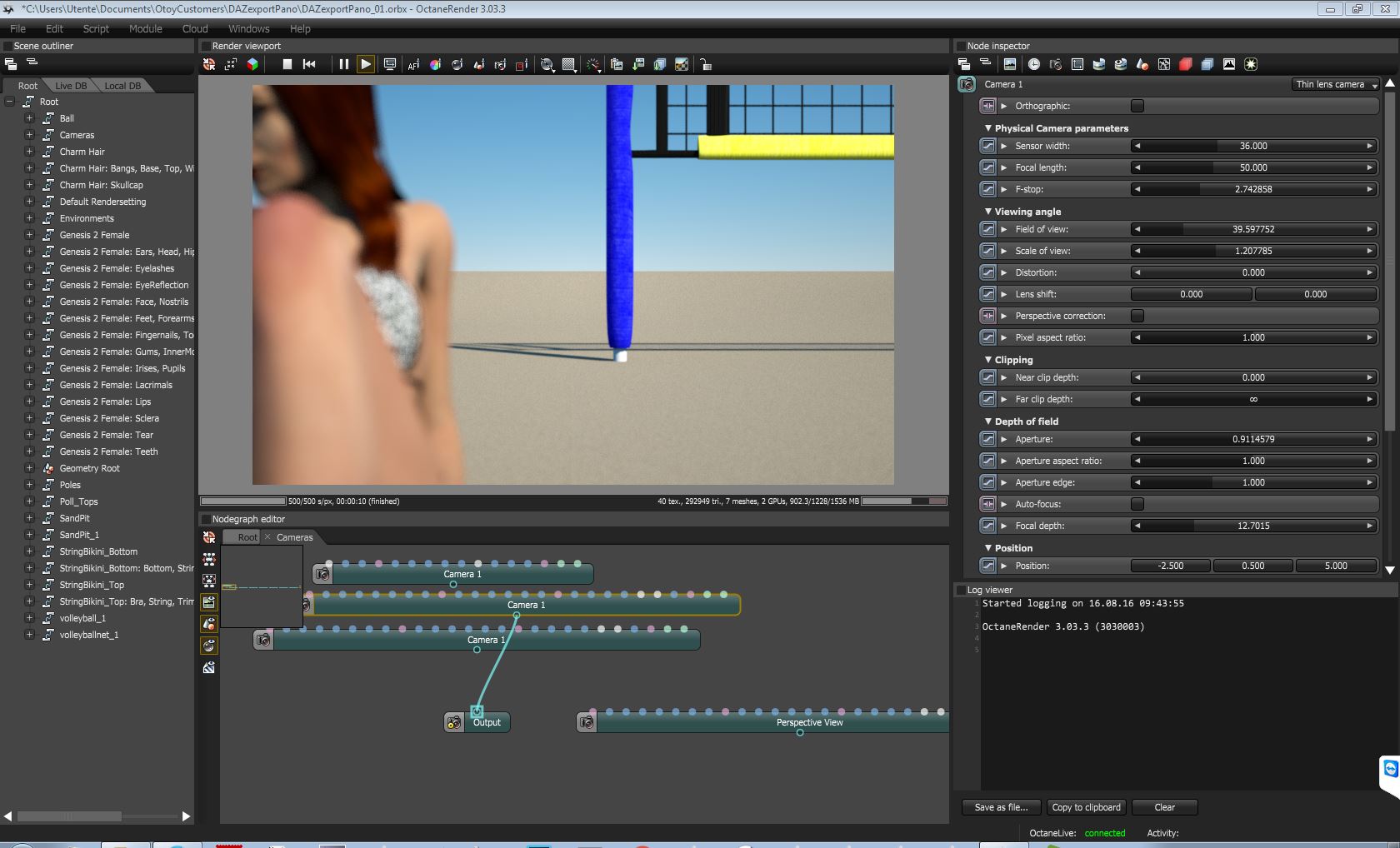

there is no jump with the Panoramic camera. I guess that what seems like a jump is the fact that the original camera has a too narrow FOV, so it seems to jump back, but is not.
What happen if you export from DAZ with a wideangle camera, like 18mm or below, then duplicate the RT and change the camera to Panoramic?
Hopefully, the "jump" effect should be gone :roll:
ciao beppe

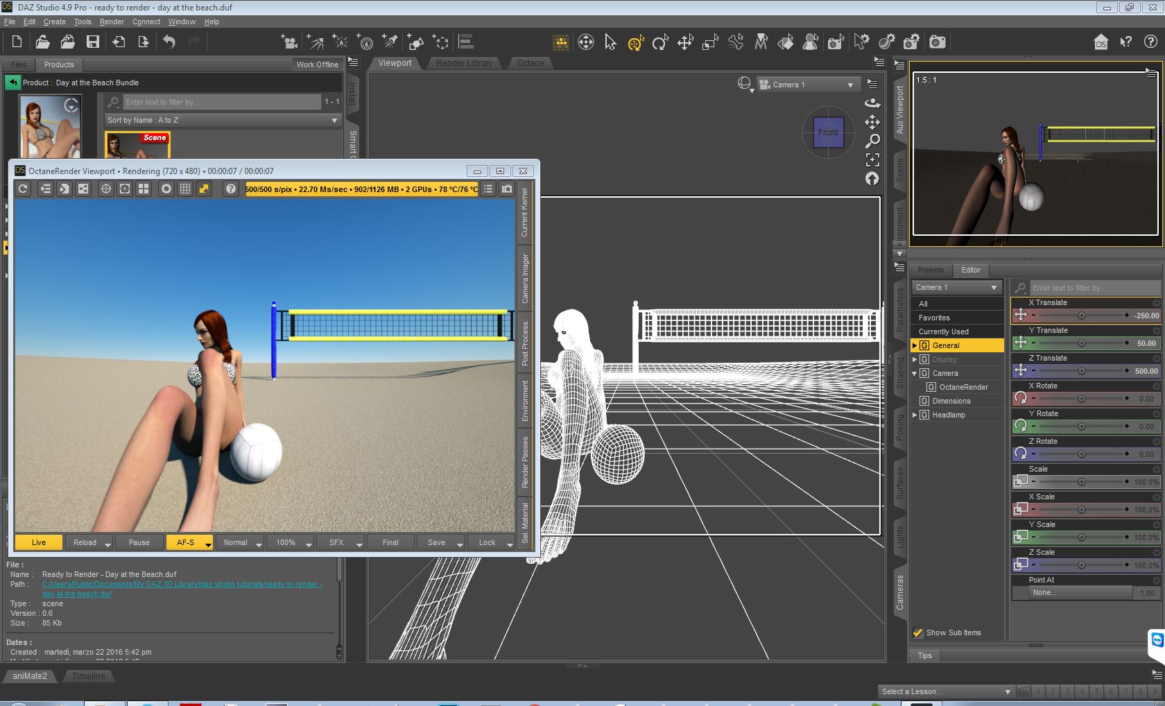

look at this example made with a frre scene from DAZ:
1. the simple scene in DAZ with a 18mm camera and 0 rotation loaded in Octane and exported to Standalone in .orbx format:

3. Duplicated the camera and changed the type to Panoramic:
as you can see, the "jump" effect is almost invisible and position of the camera doesn't change from DAZ to Standalone, only displayed in meters instead of centimeters.
4. here is the same camera duplicated but at 50mm, in switching from this camera, the "jump" effect is more noticible because of the high difference in FOV:
And here is the orbx scene for testing:
