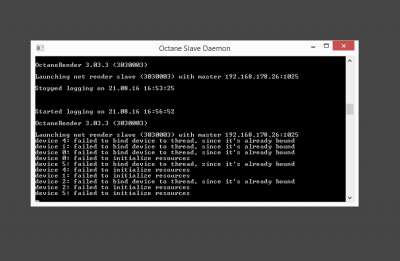

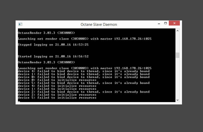

I am not sure why am I getting this on one node and not on the other. It happens on one complex scene. Otherwise this node works just fine.
This happens at a random frame of the sequence, the rendering just stops because it waits for node to respond which it never does. So overnight rendering is not safe, have to babysit it whole night.
Is this problem something new in this build, or did you have the same problem before?BorisGoreta wrote:I am not sure why am I getting this on one node and not on the other. It happens on one complex scene. Otherwise this node works just fine.
-Juanjo
