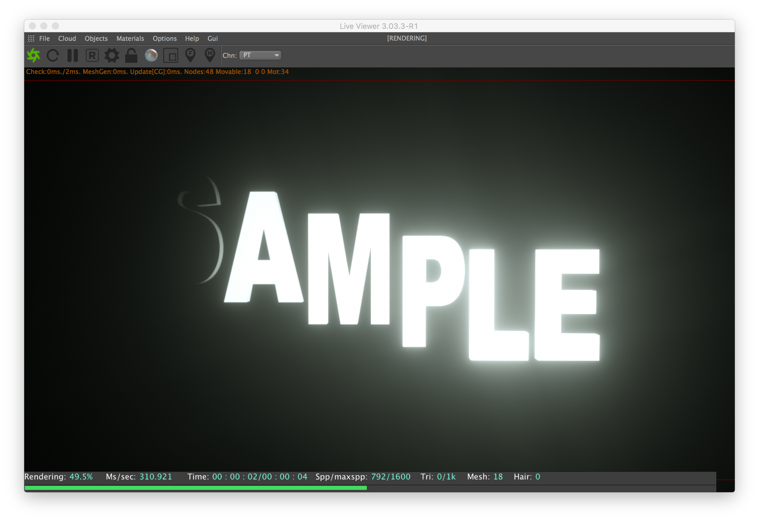

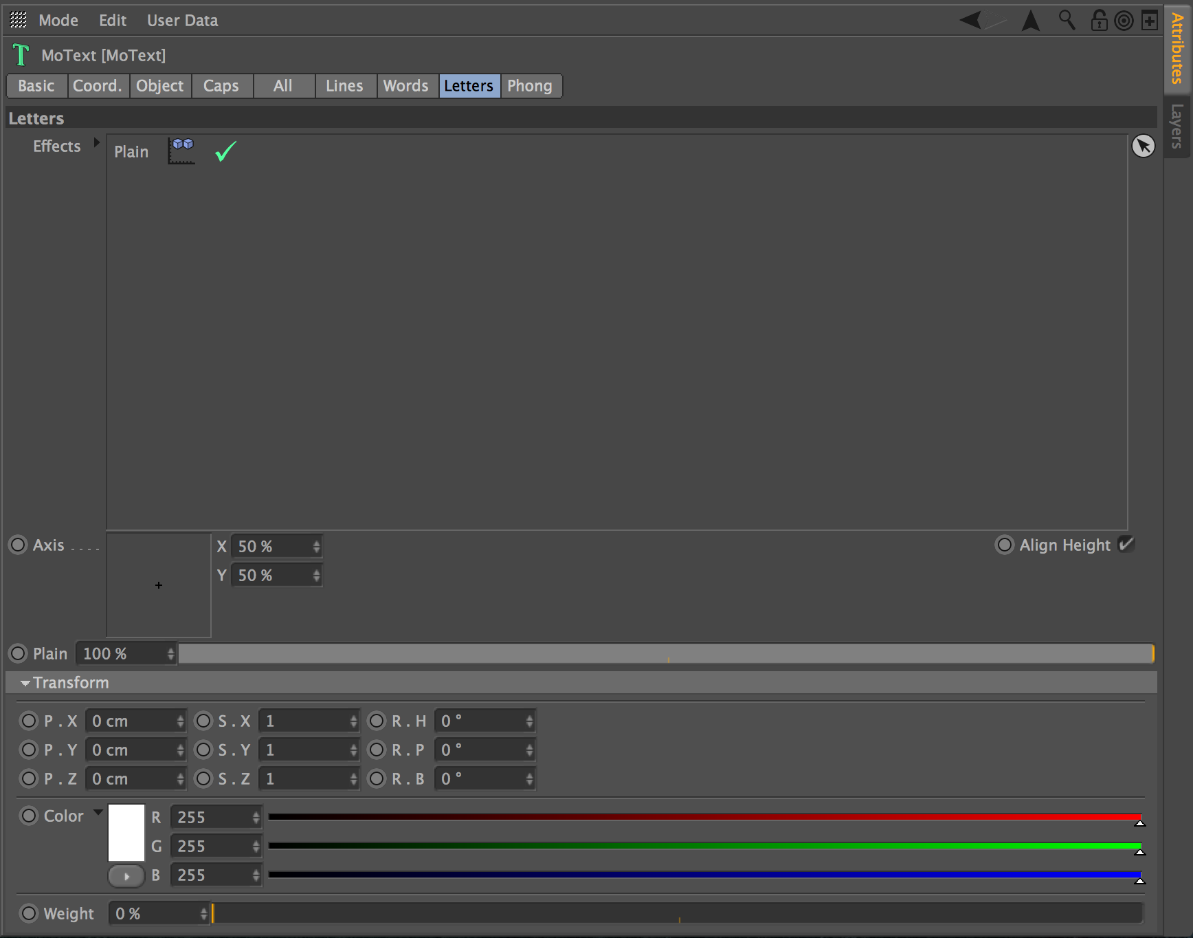

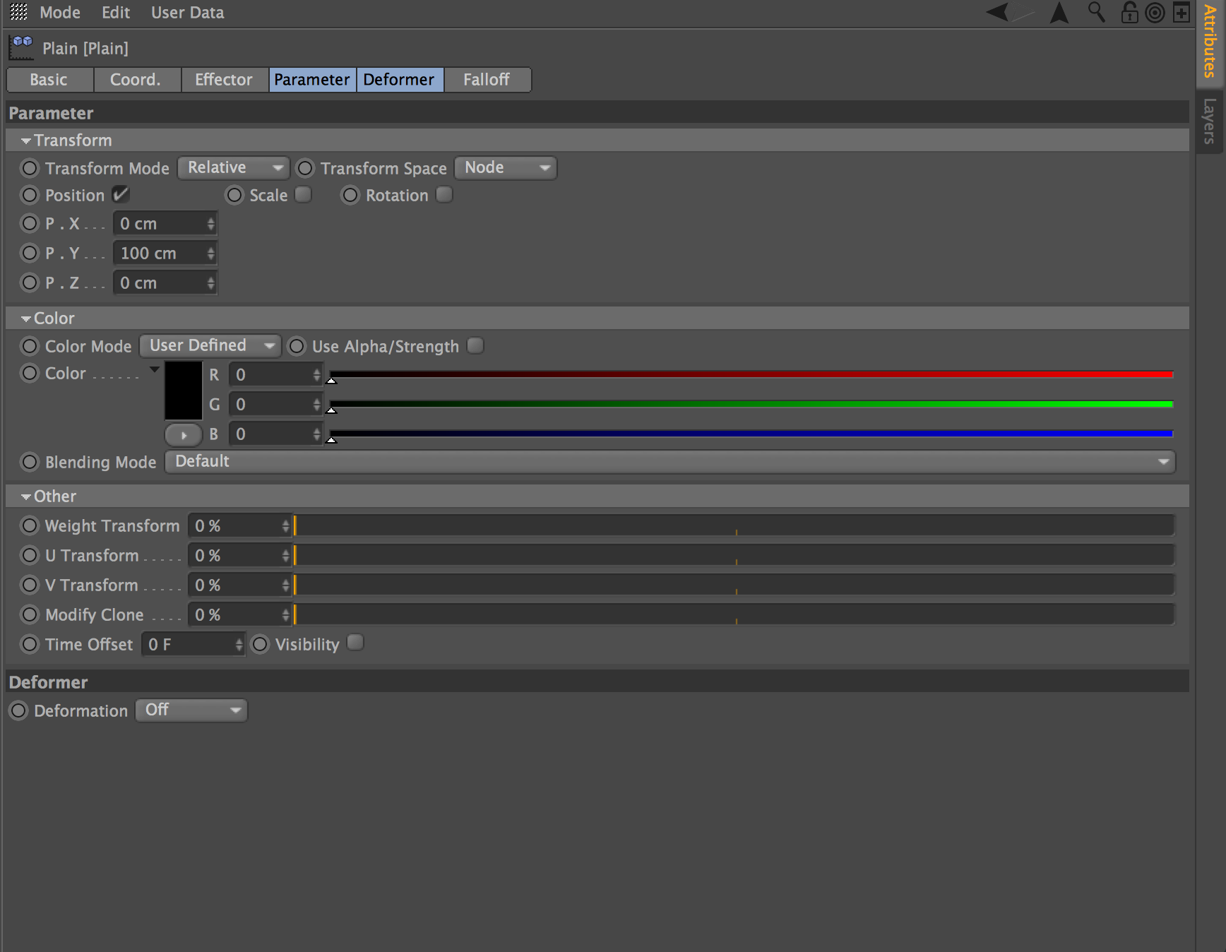

Example file attached. One thing to take into consideration for anyone recreating this, you need to set the transform of the Letters on your MoText to either White or Black and the Color in your Plain Parameter to the opposite.
