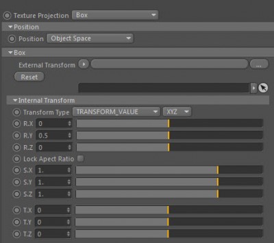

Hey fellow octane users, I have a scene with a tank and tracks.
I have created a texture for these tracks but when I animate them, they will not stick to the object :(
Love some feedback or help on how to fix this issue.
I have attached (dropbox link) the file if you want to have a play.

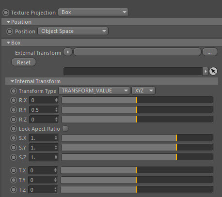

Please make a simple test scene and compare octane BOX projection vs. C4D texture tag projections over animated objects. Also you've posted on unrelated topic. We have C4D forum: viewforum.php?f=30
Here you are using textures with Octane PROJECTION(Box type on Object space). These projections are like boxes on explicit positions. It will not adopt or deformed by deformation of meshes. Think like that it sit on exact position and projects to a moving mesh.

Thank aoktar. I worked it out from this basis. Appreciate the help.
