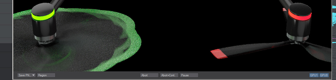

Another thing that cropped up is the motion blur on a 3 blade propeller.
It's spinning at approx. 3000rpm, and the ends the propeller have green tips.
I would have thought the blur would have been perfectly circular, but it's very asymmetric.
Any ideas?

juanjgon
Posts: 8867
Location: Spain
You could need increase the objects motion blur steps perhaps to 15 or 20 (or even more). You have this parameter in the render target root node options panel, in the MB tab.
-Juanjo
Godstrike
Posts: 128
Joined: Sat Apr 16, 2011 9:10 pm
I tried up to 12 with no difference, will bump up further. Thanks.
