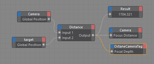

You can get the distance via the xpresso distance node
I did a small example scene but somehow it does not work currently, maybe I have overlooked something, because I know I did it that way before and it worked. Although you only need it for the Octane Camera Tag I guess. I am on 3.03.2-R4 BTW
focus.zip
(25.35 KiB) Downloaded 127 times

Thanks for the response. I know how to to get distances between two defined objects. What I am trying to figure out is how to reproduce an "autofocus" which does not need a defined "target" like the standard Xpresso distance node requires.
I am looking to make a range finder that will tell the distance of any object that comes in line with the Z vector of the camera. Thanks.

Ah sorry, my bad I overread that part with the "object crossing the Z vector of the camera" :(
