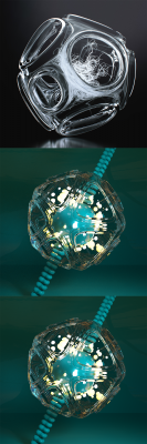

I am trying to create a glass object with little light emissions in the middle. The middle part of the glass seems to render great but the edges are very noisy. I have tried both pt and pmc which I have enclosed. The glass index is 1.1. Anyone know what settings to get a good glass render. Rawandrendered does them all the time and that is the effect I am trying to achieve. his is obviously the good one :)

it looks weird and don't think that's a noise as usual

Do you think then that it might be the geometry of the shape? It is an icosa where I have extruded and then put a cloth over it to give it depth of 10cm (now 2cm in new file) and then hypernurbed it. I can provide source file if that helps?

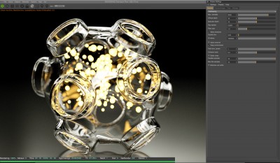

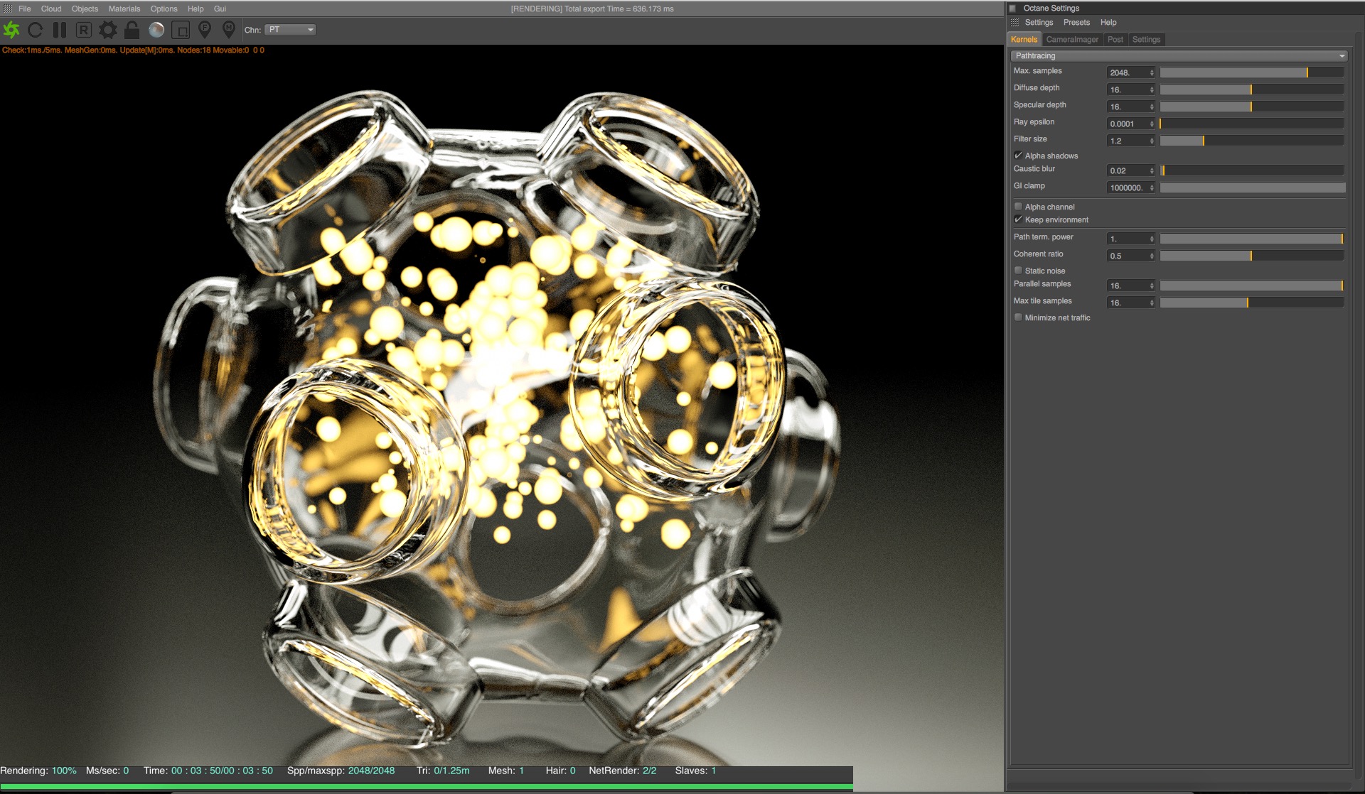

Posts: 10621
Yes, weird :roll:
I have tried to reproduce a similar scene but it cleans fast:
SpecularrEmission.zip
(155.69 KiB) Downloaded 190 times
maybe something strange in the environment settings :roll:

Thank you @bepeg4d
Your render looked sweet and was exactly what I was looking for. On close inspection I see that I gave the cloth nurbs a minus value and that is what was giving it the weird look. Changing it to a positive value made the render look more like glass.
On another note I like the model you did to as it was more spherical. Which type of sphere did you use and how many segments to get that look :)

I glad to hear that you have solved :)
your reference image is very inspiring, I have used an hexahedron sphere type with 6 segments ;)

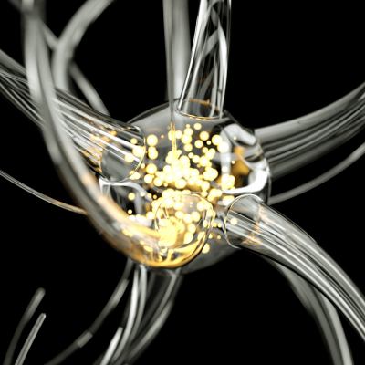

Thanks for you're help @bepeg4d
Decided to change my model a bit but pleased with the outcome thanks to your help :)
