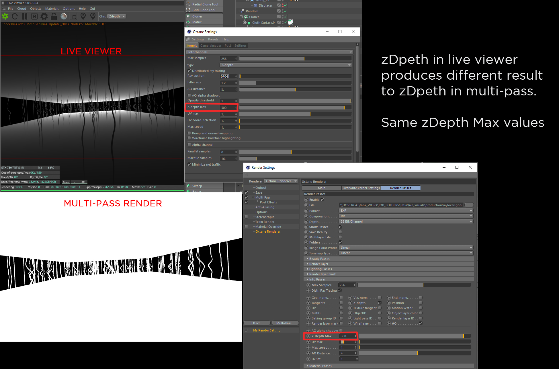

zDepth values in Octane settings from Live Viewer and Octane settings in Multi-Pass are both '300'.
But when I render out the multipass, it is all white and producing a different result to the Live Viewer. I can't seem to get any depth into the multipass regardless of what value I input.
Any help would be much appreciated!
See attachment for specifics. I can provide the scene file upon request.
Thank you! :D :D :D

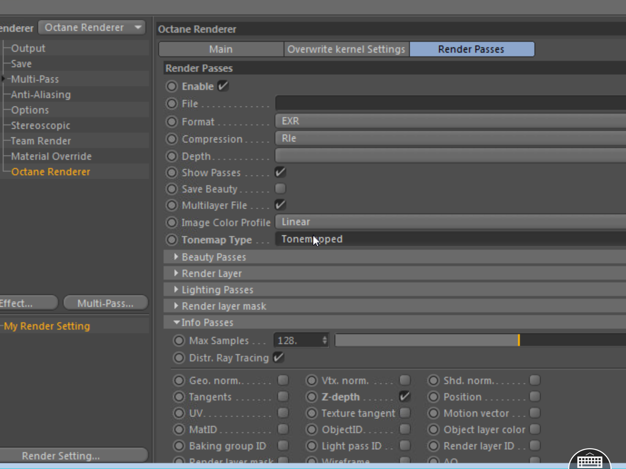

Hi jamesvde,
in the Render passes tab, try by setting the "Tonemap type" to "tonemapped" instead of "linear":
ciao beppe
Posts: 16068
Location: Türkiye
This is asked many times. LV uses TONEMAPPED results. You can do as Beppe say or tweak in compositing software. See manual for render passes.
