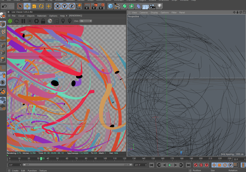

Is there any way to remove the black dots where the particles are born? I noticed them in the sample files too.
I'm creating trails from mocap so they are very visible.
Thanks is advance
Lex

hair primitives are empty cylindrical geometries. You see these open caps

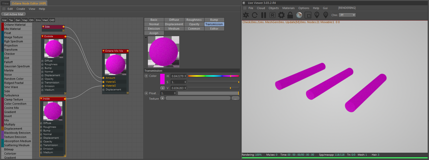

Hi
You could use material with transmission to brighten them up inside. Ugh.. It's hard to explain it in words, just check the screenshot. :)
Edit: here's the scene file
Hairtubes.zip
