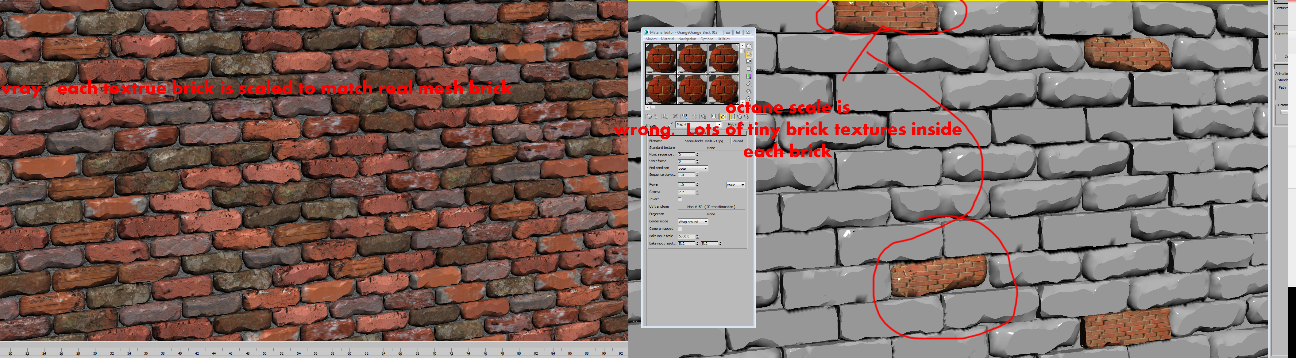

after converting material from v ray to octane not only preview turns off and mesh is grey now all UV coordinates and scale do not match

octane 2 does the same. And converting from 3ds max default scanline to octane does the same.
I attached the scene where you can try to convert, Maybe because UVW map is applied to each brick before conversion

+1 4.10 uv coordiantes not work converter vray to octane
