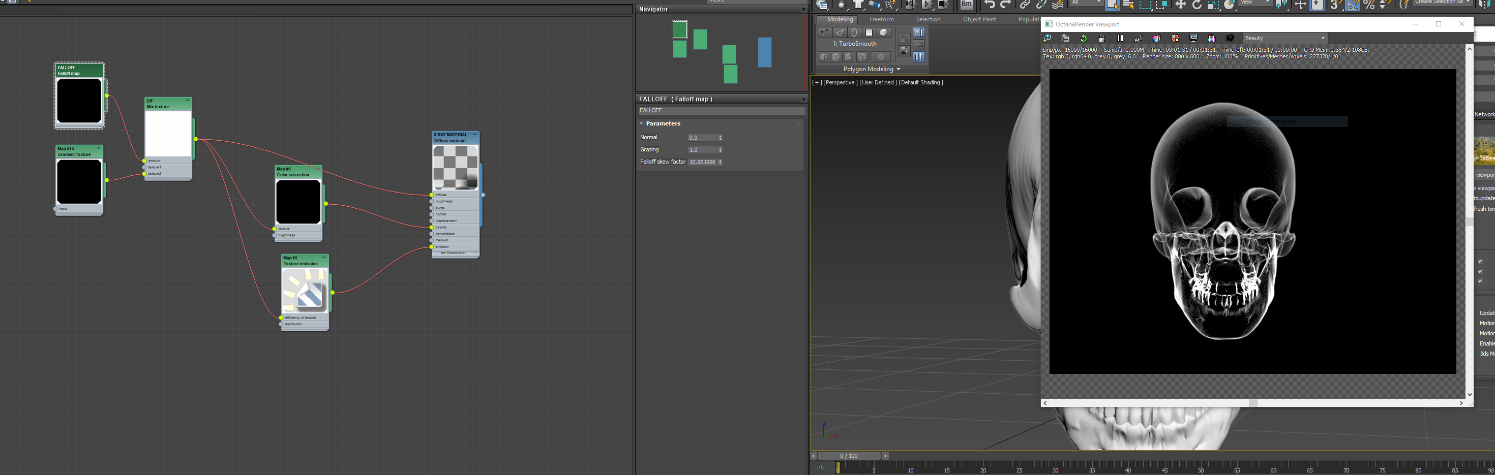

hi! someone know how create a x-ray material in Octane? once I used "falloff" in standard mat in max..but now I can't(((

Using a diffuse material with a falloff map seems to work well. The higher the "Falloff Skew Factor", the better. Perhaps you are looking for more precise details that you have not been able to achieve?
If you have screenshots of the look you are trying to achieve, it would be easier to debug your exact issue.
