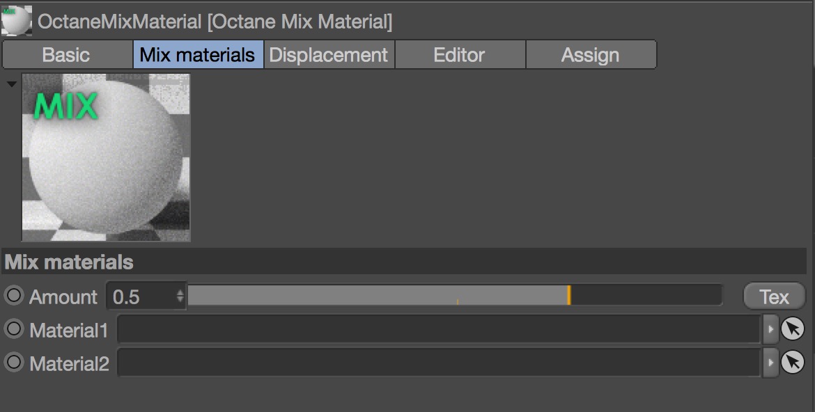

I'm not sure what version it happened on but the slider behaviour and defaults changed to less useful ones on some parameters.
Eg
Mix material amount. Why is 0.5 not the middle of the slider but about 3/4 to the right?
Light intensity - Did this change, I don't know but the range is HUGE, 0 - 100000, I rarely need go above a few 100 and most of the time below that, dragging the slider therefore is way too coarse (the little arrows are a pain to use and it takes a second to get your mouse pointer located correctly on a big 5k display. I end up typing it in all the time. PIA. Where's the function to snap to the nearest 10 when holding option key and dragging?
Ditto many others (Glare, Bloom power, Gamma and Contrast many and various shader intensities) where the useful typical ranges are crammed down one tiny part of the slider range.

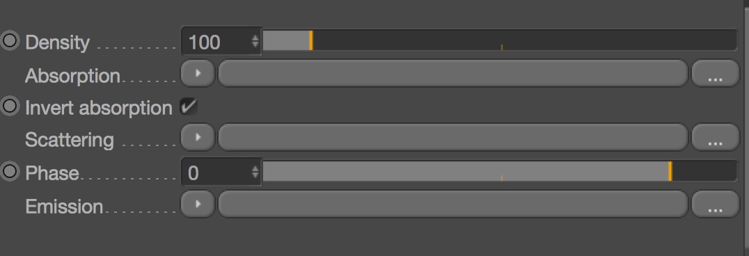

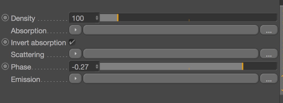

SSS Phase. What is going on with the behaviour of that slider? The mid point is -1 and the values go in reverse when you drag past it...

Can you be more specific? I don't see anything on mix slider,etc... as you said. Which version? Any images to show this problem?

Octane 3.00-R1.1
Cinema 17.048
OSX 10.11.5

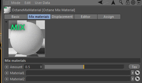

try with latest builds. I've added c4d slider type then removed because was not working well with ranges, etc...
sdanaher
Posts: 332
Joined: Mon Apr 06, 2015 12:47 pm
aoktar wrote:try with latest builds. I've added c4d slider type then removed because was not working well with ranges, etc...
Seems to work better. Can we have snapping to whole (or x10) values when holding alt?

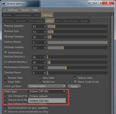

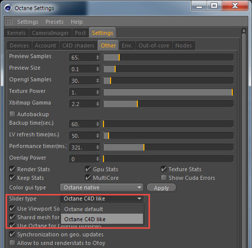

sdanaher wrote:And could we at least have the slider stop at its maximum value (eg 1.0) when moved all the way to the right?
They stop at maximum values if they have max=1 or max=10 or similar. Don't involve them with MAX and SLIDERMAX. Which sliders doesn't stop at max? Are you using "Octane default" or "Octane C4D like" with some recent builds like 3.03.2?
Also some sliders have logaritmic behaviour as in standalone. Nothing is different than STANDALONE for parameter ranges and behaviour if i haven't missed to syhnc someone.
Brightness in Colour Correction node for example.
I have the same settings as in your pic.
Windows 10 - 64GB RAM - Cinema 4D R20 - RTX 2070 x3
