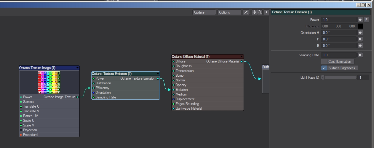

Your best chance to use baked diffuse maps is to apply them linked to the texture emission node using the "efficiency" input. You must set the "power" to 1.0, disable the "cast illumination" and enable the "surface brightness". You must also be sure that that diffuse parameter in the material is set to black.

Thanks Juanjo,
So I will have to use a mix material to allow reflections. Sounds like it'll be difficult to match the pre baked version, compared to the LW way of doing this. Cheers.

I tried baking out a colour clay render as the 'coloured diffuse', then applying the diffuse as Juanjo mentioned above.
Using direct lighting/none mode, you can get the diffuse surfaces to look ok, however trying to get the correct reflections is not possible.
The only option available is to mix the diffuse and glossy material, when what we really need is a blend multiply/screen type material mixer.
I could render out a reflection only pass and comp later, just it'd be nice to be able to preview in Octane. Alternatively, bake in Octane and do the rest in LW.
