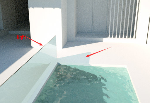

How to control the strength of the shadow
i use a rgbspectrum in transmission with glassmaterial and use fake shadows
i want control the shadow strength without change light and opacity
how control glass shadows strength
Hi carterner,
I guess that the more accurate way is to activate Render Pass/ Render Layers/ Colored Shadow. In this way you have the colored shadow in a separate layer in Photoshop and you could adjust it as you want

thank you very muchbepeg4d wrote:Hi carterner,
