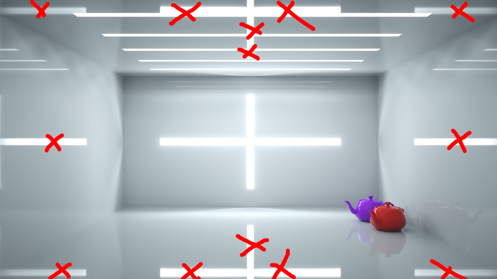

We need a function to ignore reflections light

Would it be ok to make the light source invisible? There is still an issue with the multiple importance sampling of transparent light sources, but I've got a fix for that and would like to know if that approach would be valid for you.

for cinema , directors sometimes do not need extra light reflection , but want to gloss material , and then begin problemmyabstrax wrote:Would it be ok to make the light source invisible? There is still an issue with the multiple importance sampling of transparent light sources, but I've got a fix for that and would like to know if that approach would be valid for you.
Vray function
